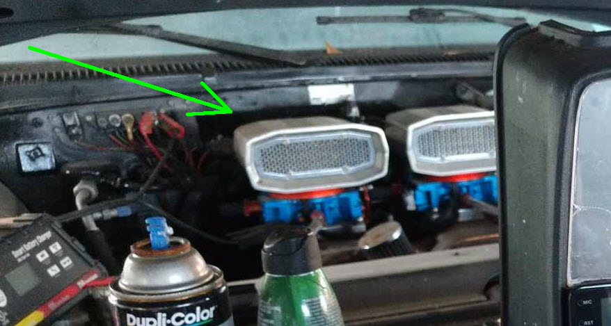

Sorry to sidetrack this a little but what's going on here?
 [This message has been edited by IMSA GT (edited 01-17-2021).]
