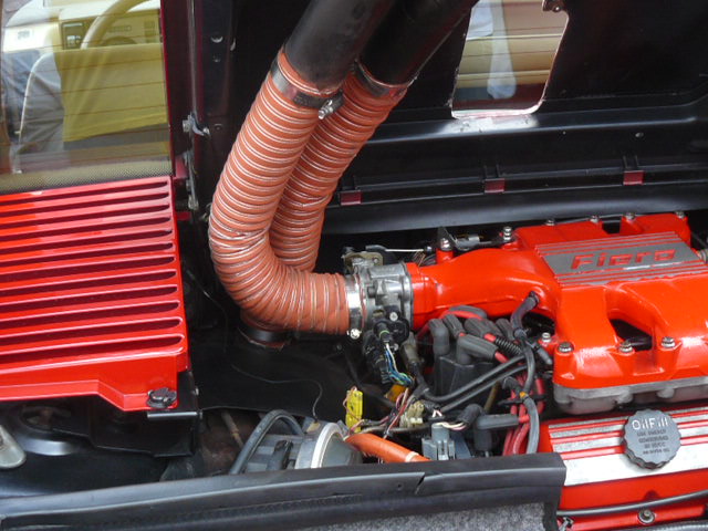

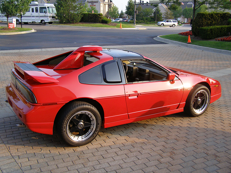

Not sure if this has been discussed before (I'm sure it has at some point), but has anyone seen this turbo Fiero with the intercooler housed in the spoiler? It's the second car in the video, at about 51 seconds. Very interesting!

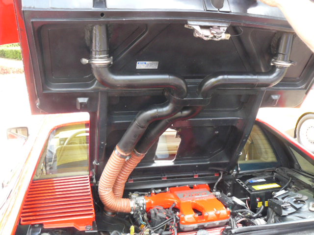

im doing something similar only its mounted in rear trunk and is vented through the deck lid....

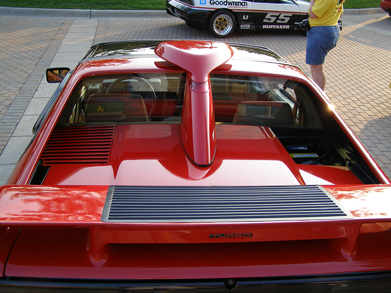

That was a prototype car. There was some debate whether there was enough airflow to actually make use of the intercooler.

This car was originally called the Porsche Eater. It was built along with a Black car in 1984/85.
It originally was a GT coupe and had a 2.9 Turbo Engine in the car.
Not sure what engine is in the car today. This car has seen a number of changes over the years.
The black car is still around pad in a museum in Northern Europe. It is still a coupe but it was given the DGP body kit with the GT wing. It retains this look from 1985. I believe the 2.9 was removed for other show cars.
Both cars were called Porsche Eaters due to the powerful 2.9 engines and the tail lamps that would light up saying Porsche Eater in the lens.
The air flow here I expect was more than enough as these turbo systems are based on much older low flow and pressure systems. They are not like today’s systems that are pulling mega boost and flow.

IMO, the system is a novel design but highly impractical. When you close the deck lid you have two flexible hoses dangling near or on the exhaust. Fire hazard, maybe? Also those long tubes in the engine compartment can really get hot negating the function of the intercooler. The system looks nice for a prototype show car but that might be it. ------------------ " THE BLACK PARALYZER" -87GT 3800SC Series III engine, custom ZZP /Frozen Boost Intercooler setup, 3.4" Pulley, Northstar TB, LS1 MAF, 3" Spintech/Hedman Exhaust, P-log Manifold, Autolite 104's, MSD wires, Custom CAI, 4T65eHD w. custom axles, Champion Radiator, S10 Brake Booster, HP Tuners VCM Suite. "THE COLUSSUS" 87GT - ALL OUT 3.4L Turbocharged engine, Garrett Hybrid Turbo, MSD ign., modified TH125H " ON THE LOOSE WITHOUT THE JUICE "

Hard to say how much hazard if it is high temp hose or not. It has never burned and the car in the past did get driven.
Also this was a car built in the late 80’s. Much has changed since then in Turbo tech. Things were no where as effective, efficient or durable. We had just seen the first water cooled turbochargers on the GN a few years before.
The greater issue is the lack of air flow. Not much air travel to the spoiler anyways. I recall driving in the winter and the snow would remain on the spoiler accept for the ends where the vent heat blew over it.[This message has been edited by hyperv6 (edited 12-23-2020).]
Yeah it was really the novelty of it that caught my interest. Practicality may not be there but I thought it was a unique and interesting design.
