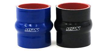

If you do proceed with the rigid tube modification, I recommend a silicone hump coupling to link the air filter with the rigid tube:
The hump will give more flexibility than that of a straight coupling. Ideally you should have a hump coupling at both ends of the rigid tube.
