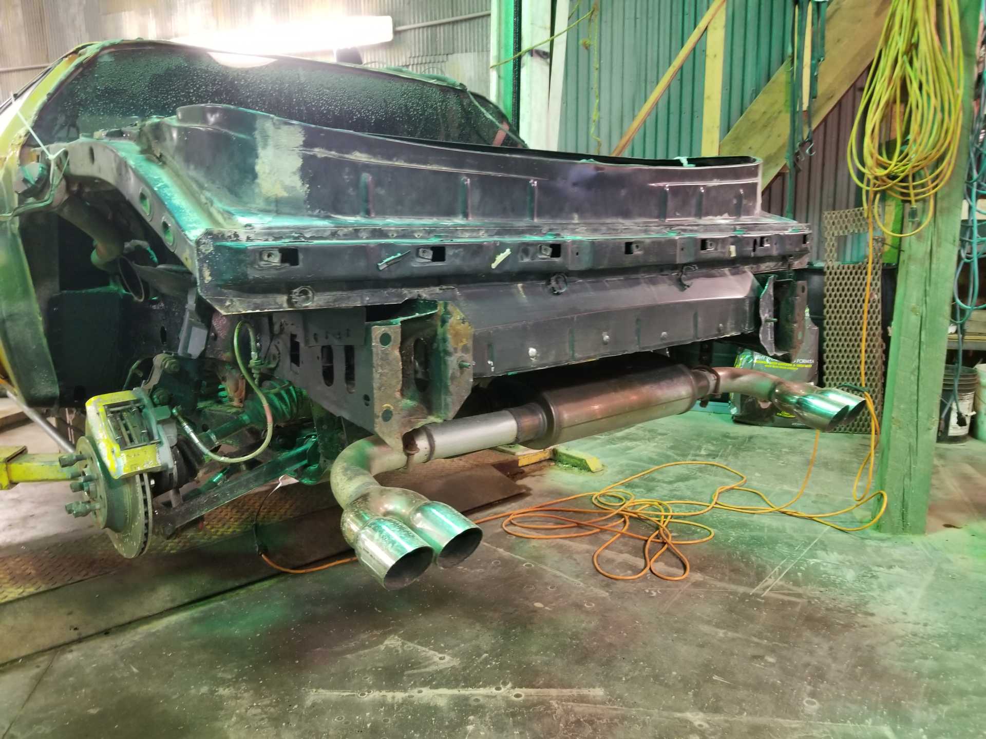

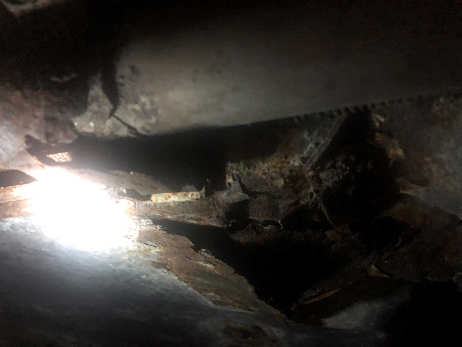

I happily drove my new 1985 GT for about 40 miles and love the car but it's now time to start taking it apart. Initially I thought it just needed a good clean and paint but after starting to take it apart a little I found that as any 35 year old Midwest car I do have some rust. So far I have taken out the driver side rocker panels (damn those rivets), both driver side fender liners and the trunk carpet. And I did find some rust. There is a hole going from the trunk into the frame rails in the trunk but I am thinking the frame rails is rusty but still solid. I am not so confident when it comes to the passenger side. There are some small patches in the floor pans but I don't think they will be a major issue (other than now having to remove most of the interior, but I guess that will allow for better cleaning). There is one spot on the floorpan where it looks like the frame meets up with it that is bad but I don't think the connection between the floorpan and the frame is compromised. And finally the brackets that hold the cooling pipe to the body in the middle are really bad (are there reproductions available for these?)
So in short I think it will end up being more a restoration then a refresh but that will keep me off the street I guess.
I do want to inspect the frame much better and to do so I think I will need to take the rear clip off. Is that possible without taking the roof off? I really don't want to remove the roof since I don't want it to crack.

I replaced the rails and very large areas of the truck sides on an '84 I restored. It wasn't as bad as a lot of people made it out to be.. but I am a decent welder and have all the tools, lifts etc. I put the car on a frame puller afterward and had to slightly tweak it about 1/4" on the right rear to get the rear clip to align with the deck properly and perfect the gaps.
The new owner has put over 60k miles on it without issue, and the POR15 is still like new on the rails/trunk.

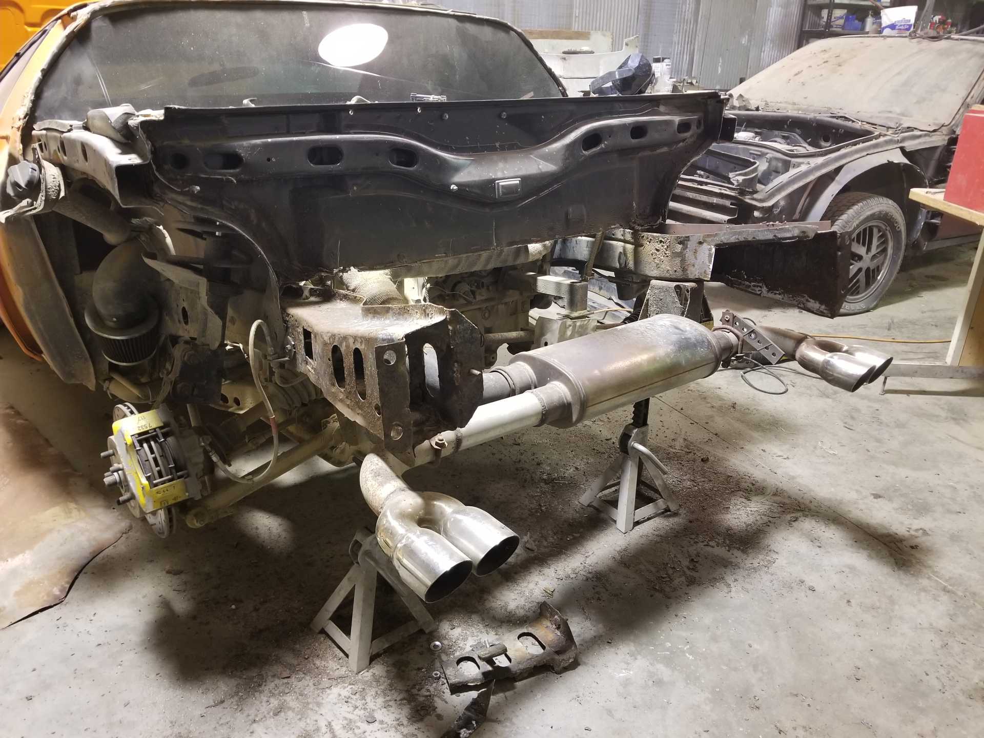

I got the rear passenger fender liner and the bumper off yesterday and the rust looks ok. It doesn't look like the structural integrity of the frame is affected. So lots of cleaning and welding in patches and then painting the crap out of it with POR 15. Does anyone have experience with it and do you need to go down to bare metal for it?

The girl is naked now and luckily the rust is limited to sheet metal and the frame is ok. So some cutting and welding then lots of POR 15. Seems pretty straight forward.
