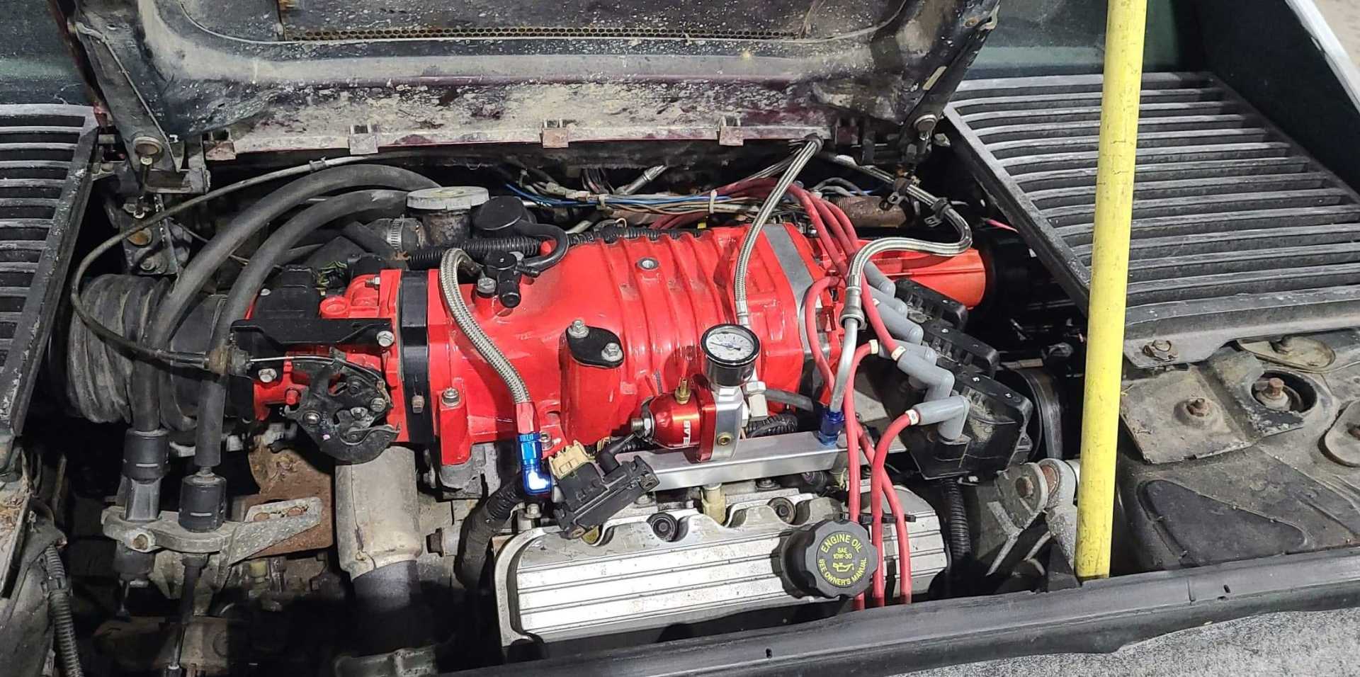

| quote | Originally posted by Fiero Thomas:
....Installed zzp coil packs and 10.5mm spark plug wires....
In my opinion, the 10.5mm plug wires are not very good. I had a set and one of the wire boots melted! Another one started to short out when hot. The size of these wires makes them prone to be too close to the exhaust manifolds.
I went back to stock style wires from RockAuto - not even an expensive set! And because you can bend these wires up and away from the manifold quickly, they don't get as near to the hot parts. Since then I've had no ignition problems.
Regards, Rafe------------------ "Turbo Slug" - '87 Fiero GT. 3800 turbo. Sticky tyres. Driven hard! https://www.youtube.com/cha...1wZvWQlkYxTjivW_0XNg

Congrats and welcome to the 3800 SC Club
As for zzp coil packs sorry but they are not as good as factory ones. I had a set and quickly returned back to originals. Looking forward to some mods that only daddy knows best lol
