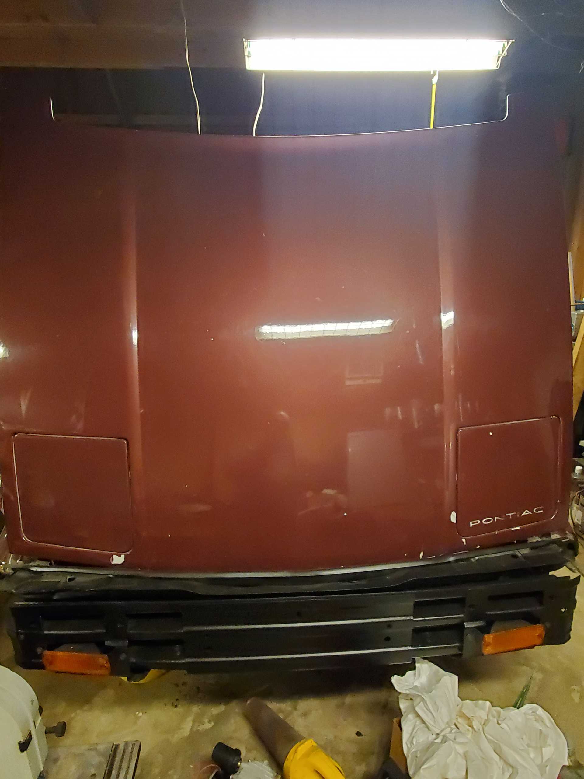

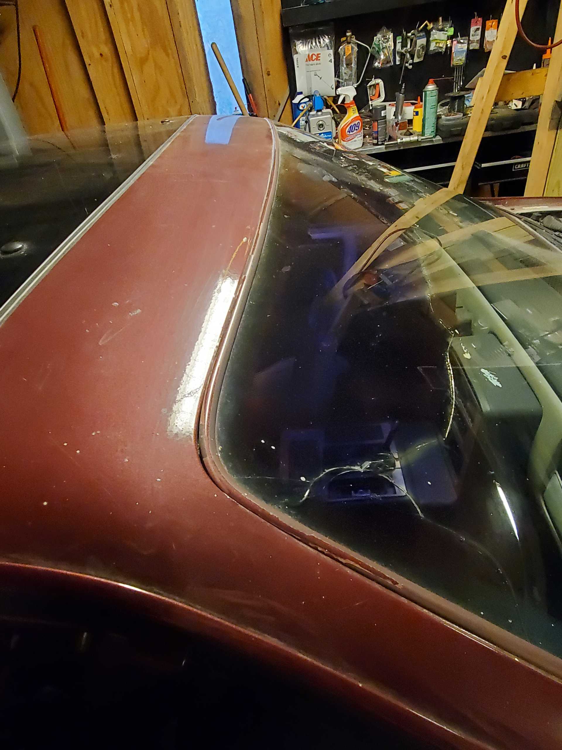

Here's a few pics of what I'm starting with, the swap in panels are white and what I'm missing is hood, power mirrors, & fuel door to match
Currently working on getting wheels polished and will look into getting a few shop quotes for comparison purposes. How much a pain would it be converting the current hood color over?
