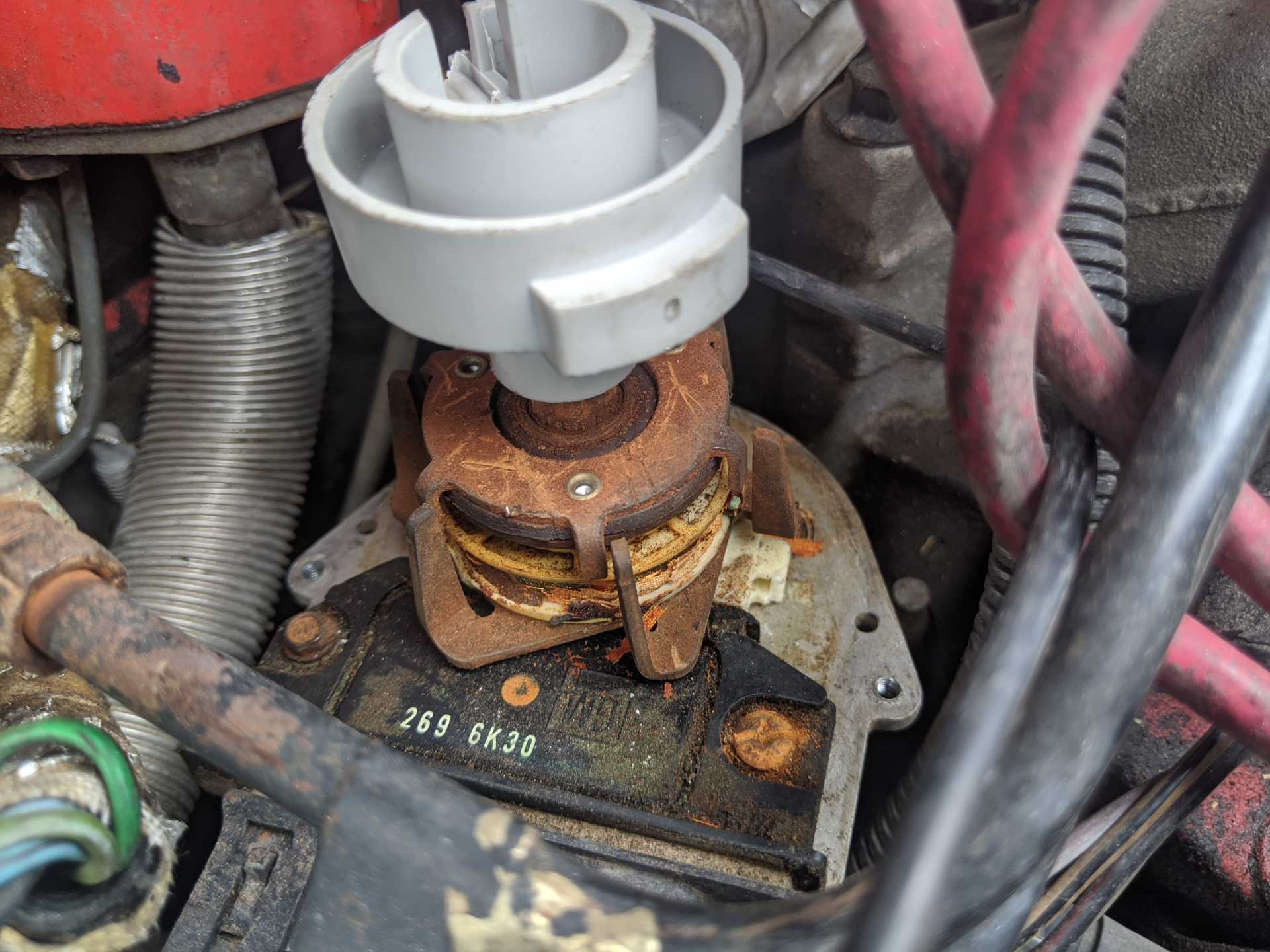

After being Fiero-less for the past few years, I just picked up an 88 Formula 5 speed, and my original intent was to DD while gradually upgrading the suspension and working on other big projects, then finally doing a 3800 swap with cam, intercooler, pulley, etc. Unfortunately, I have found that this car has a couple of significant issues. I think the pickup coil is going out because it runs fine when cool, but starts stalling and backfiring once heat soaked (the coil itself is rusting and flaking bits off). Also, 5th gear grinds and pops out when I let the clutch out, and 1st is starting to do the same. To add insult to injury, my trailer lost an entire 6 lug wheel and tire the night I was towing it back. An inauspicious start to my new toy.
Don't be surprised if it's actually the ICM that's dying. It's not uncommon for the ICM to fail when it heats up, and then act "normal" again when it cools down.

I think both are due for replacement. I ordered a whole new distributor assembly, so that will cover both. If nothing else, it should add value to resale of the engine if I can confirm it's running well.

My suggestion would be to get the Cardone distributer. It comes with a new pickup coil and ICM. And IMO it's a better design than stock.
So, why replace the entire distributer? Well, yours is over 30 years old. It probably needs a rebuild. I'm sure it has a lot of end-play by now. You can disassemble it to rebuild it, or just drop in a new one. Your choice.

| quote | Originally posted by Stricken:
 | | CLICK FOR FULL SIZE |
I ordered a whole new distributor assembly...
Compared to what mine used to look like, that one looks pretty good.
| quote | Originally posted by Patrick Here:
No, this isn't some discarded distributor I found laying in a ditch in a bone yard. This is the distributor out of my '86 GT that I bought a few months ago. (The car had been sitting for six years.) I can't believe the engine ran (and actually ran well) with all this corrosion in the distributor.
I cleaned it up, replaced the pickup coil (and eventually the ICM), added a heatsink to the bottom of the distributor... and 12 years later this distributor is still going strong.
| quote | Originally posted by Blacktree:
While I completely agree that the Cardone dstributor is a more robust design than the original, my concern would be with the no-name ICM that it utilizes. Sure, a preferred ACDelco ICM can be swapped in, but now we're looking at this additional expense, and depending where the ACDelco ICM is purchased, it can be a little pricey. Believe it or not, here in Canada at Lordco Auto Parts, a well known (ripoff) automotive parts chain, an ACDelco D1984A ICM lists for $257.99(CDN)... or $197 in US funds!  [This message has been edited by Patrick (edited 09-01-2020).]
