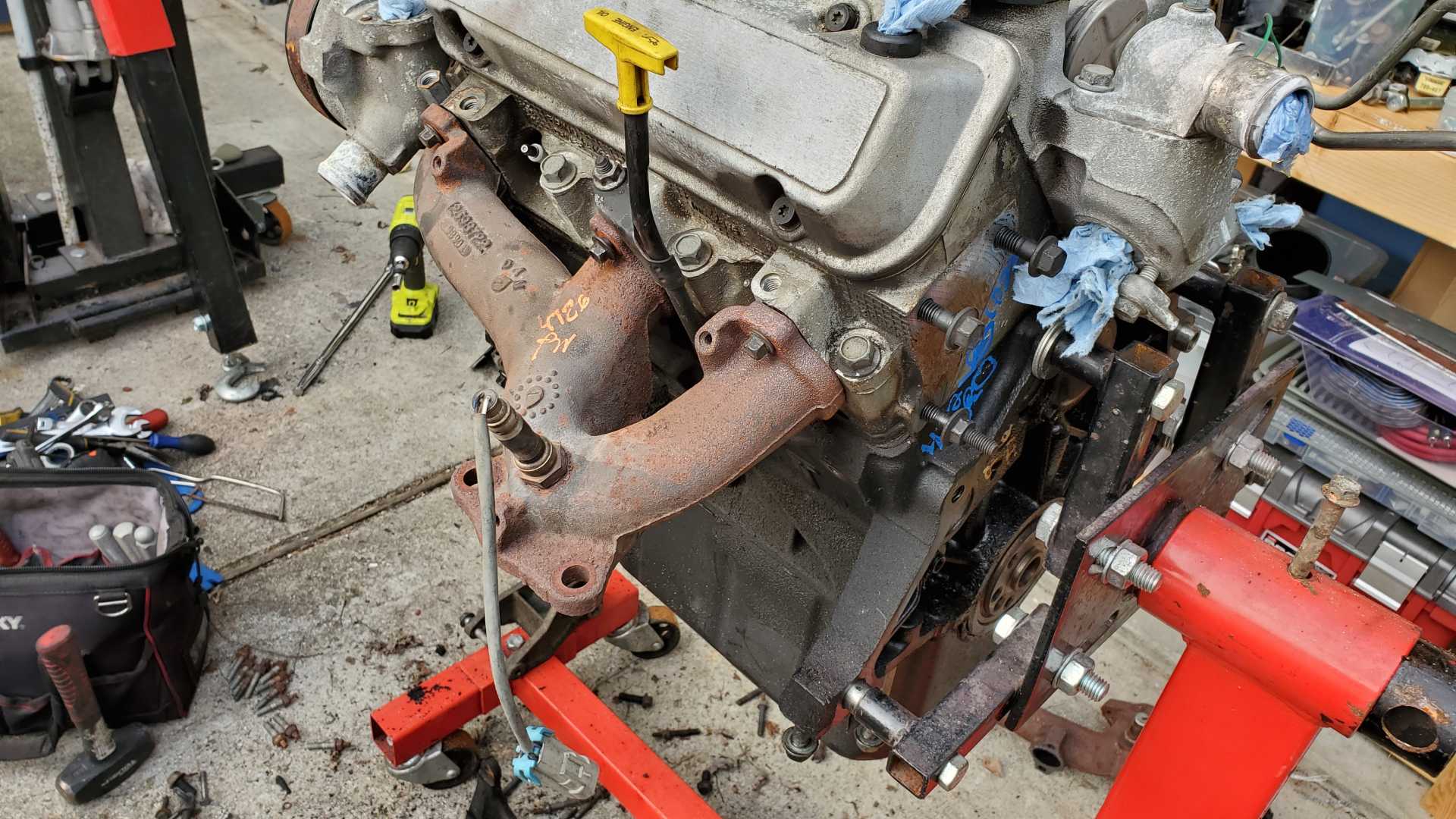

EDIT: Thought I'd add some photos of the 3500 exhaust manifolds sitting on my 3.1L motor. They fit fine and the "D" port is slightly larger than the "O" port 3.1L exhaust ports.

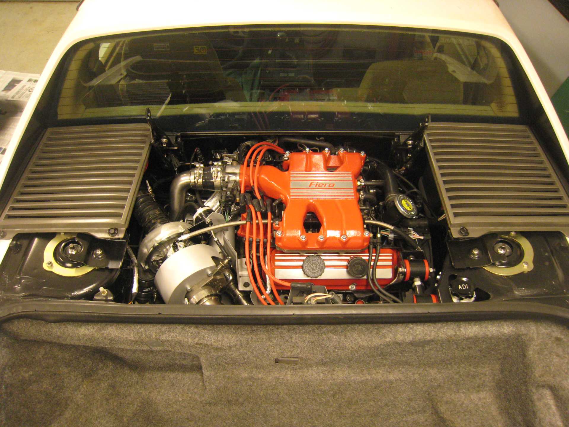

| quote | Originally posted by qwikgta: Having read tons of threads on Pennocks, I was 50/50 that I could just remove the non-Fiero bits off this 3.1 and put on all the extra crap I have for a 2.8 and make this a runner, but after I got home and started reading about it I found out that I can't. I knew to stay away from the 3x00 motors b/c of the difference but I thought the Gen II 3.1 would work.
Huh?
This here is my Gen II 3.1 engine dressed up in Fiero parts:
Yes, it has a compression ratio of 7.4, and it runs fine.
Yes, there's a turbo, but most of the time when the turbo isn't spooled, the engine works just like any other naturally aspirated engine.[This message has been edited by pmbrunelle (edited 08-24-2020).]
