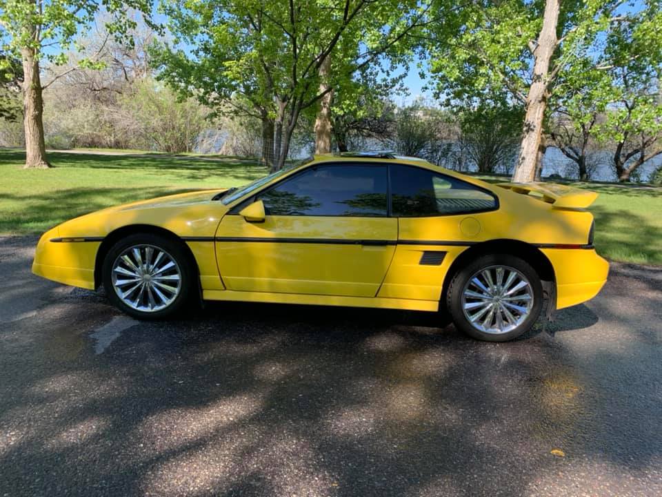

I am looking at buying a 86 GT and the owner says that the Fiero has never been repainted.

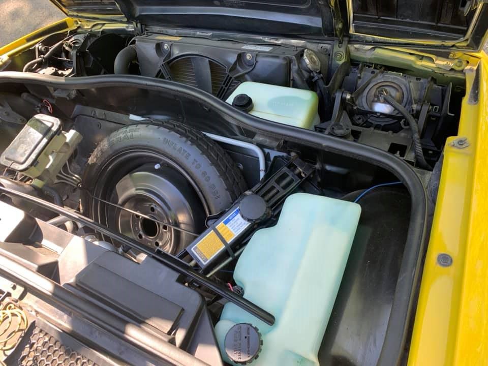

That has definitely been resprayed. Fiero body panels were painted prior to assembly on the space frame, the only overspray that's factory was around the headlight door openings.

no expert here but it appears to be resprayed IMO

Good looking car, but if the seller is lying about the paint, what else are they lying about.

On the factory blue 85 that Paul McKibben and I found, it had a color override notation on the SPID label. This car doesn't have that, but I guess it could still be a factory paint job. Look through the front cowling mesh and see if you can see the color on the piece of the roof that rests below the windshield. A good repaint might still have never have touched that and if it was a silver car it might still show that there. I'm with the others about the overspray, but check that part under the cowling mesh and let us know!

Edited for one more thought. The mirrors have been painted the body color and on the blue 85 the mirrors were stock black. I'd take the yellow mirrors as one more sign of an overall non-factory repaint.

I agree. IIRC the aero rocker kits on '86 GT were contrasting colours to the body colour. If correct, having the same colour all over would tend to make me believe it's been resprayed. A panel-off respray is pricey and labour intensive. No guarantee but you could try to remove a fender bolt under the hood and see if it's been painted panel-off or panel-on. You could also try removing the plastic covers in the door sill over the rivets holding the rocker panel on. These pop off if you do it carefully. You might get a good indication of what the aero molding colour was originally.

Silver Metallic paint code, overspray where there shouldn't be any overspray, mirrors and aero body effects painted too.... I don't think there's any doubt. It's a repaint.
