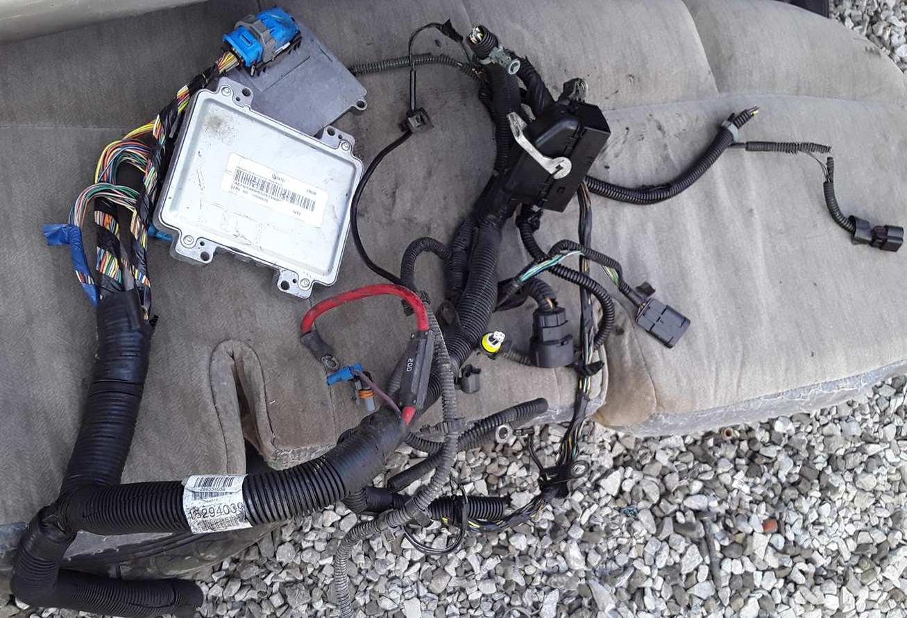

So, this '06 LS4 I picked up, do I want this harness portion, PCM and TCM as well?
