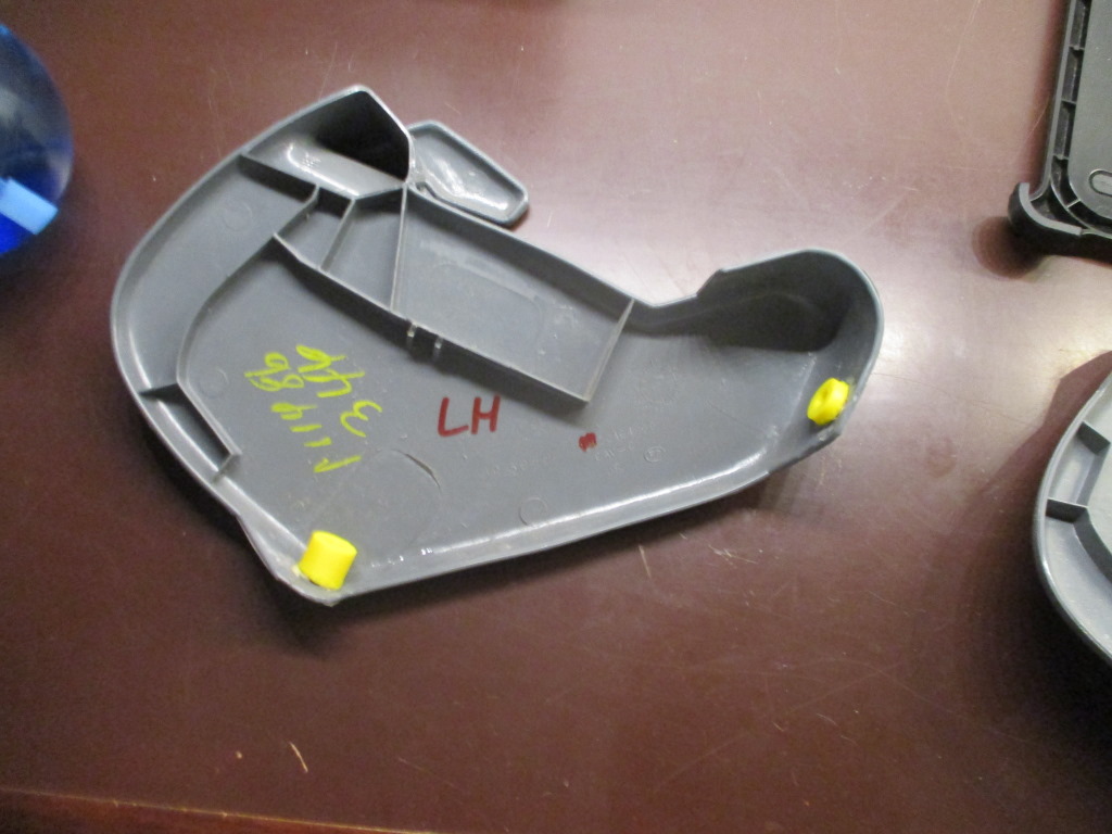

Does anyone have a 3D printing schematic for the driver's side plastic recline cover? The one on Dad's original Mr. Mike's seats is broken in three places (center tab, and both screw holes are broken). I'm hoping someone might have some .stl files read to go...otherwise I guess I'm taking a trip to the junkyard...

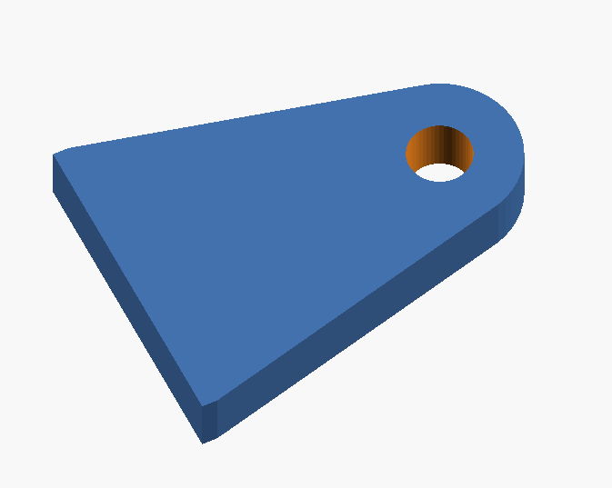

If I'm thinking of the right thing, the screw holes are easy, they're just cylinders with a hole down the middle.
Here's OpenSCAD for them
code:
$fn=50;
high=13; // there are two, one 5mm and one 13mm
difference() { color("blue") cylinder(d=15, h=high, center=true); color("blue") cylinder(d=7, h=high+.1, center=true); }
You can modify as you see fit.
The middle might be like #6 on
http://www.mrmikes.com/fieroquestions.htm
center of my pic above, which I think I did with something like
code:
$fn=50;
thick=8;
color("blue") cube(size=[18,7.5,thick], center=true);
translate(v=[14,0,0]) { difference() { color("red") cube(size=[10,15,thick], center=true); translate(v=[1,0,0]) color("black") cylinder(h=thick+.1, d=3, center=true); } }
You can get OpenSCAD from openscad.org, load the text above and hit F6 to render, then F7 to export to STL (assuming Windows, Mac might be different.) You can then modify-scale-whatever as you see fit, so I figure it's better than just giving you my STL's which worked for me but might not for you. Open source Fiero parts, right?

Depende en que filament you printed with. Mine was ABS, and I *think* the trim piece is also ABS, so I used this stuff
https://www.tapplastics.com/weld_on_16_cement
Which melts a smidge like a plastic weld into acrylic, ABS, and IIRC does well with PLA. too.
You can also use CA glue ("superglue"), though I find the regular stuff is too brittle and cracks if you look at it funny, so prefer the gel.
If you wanna go nuclear, can also do like a Gorilla glue (water activated) or a two-part epoxy, but I think either of those are overkill.
In either case, though it's prolly obvious, clean both side REALLY well. File the bottom of your newly printed parts to get off any tape or Elmer's glue or whatever from your printing, and clean the living snot out of the trim piece 'cuz it's 30 years old. Mine I hit with the Dremel and one of those little dentist-style diamond burrs to flatten and scuff the bonding surface. Do love me the Dremel =))
