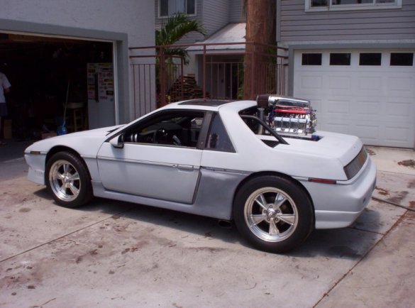

Thats Tracy Powell. I believe he was from Florida. The engine is a blown 455. Lee on here (Larini74) posted this back in 2006:
| quote | Engine and transmission came out of an 1967 Oldsmobile Toronado. Modifed of course, with a variable pitch torque converter with 3k stall speed to handle the almost 750hp that the engine puts out. |
Unfortunately, Lee's webpage is gone with all the photos. Here is another pic:

So is the variable pitch torque converter whats allowing him to mount the engine facing forward?
liv4God
MAY 28, 05:40 AM
| quote | Originally posted by Miller5862: So is the variable pitch torque converter whats allowing him to mount the engine facing forward? |
The Tornado transmission is the key. It was made for a longitudinally mounted engine, where the Fiero and most front wheel drive cars are transverse.

fieroguru
MAY 28, 08:51 AM
TH425 is the transmission.
