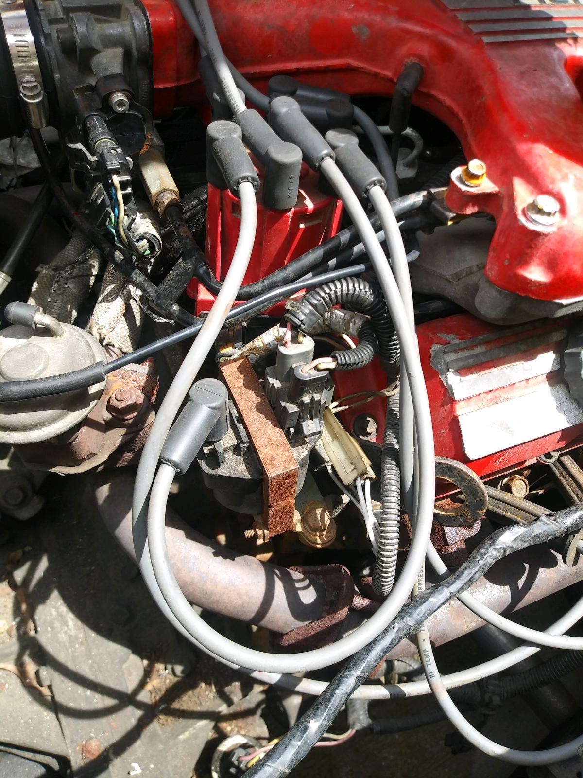

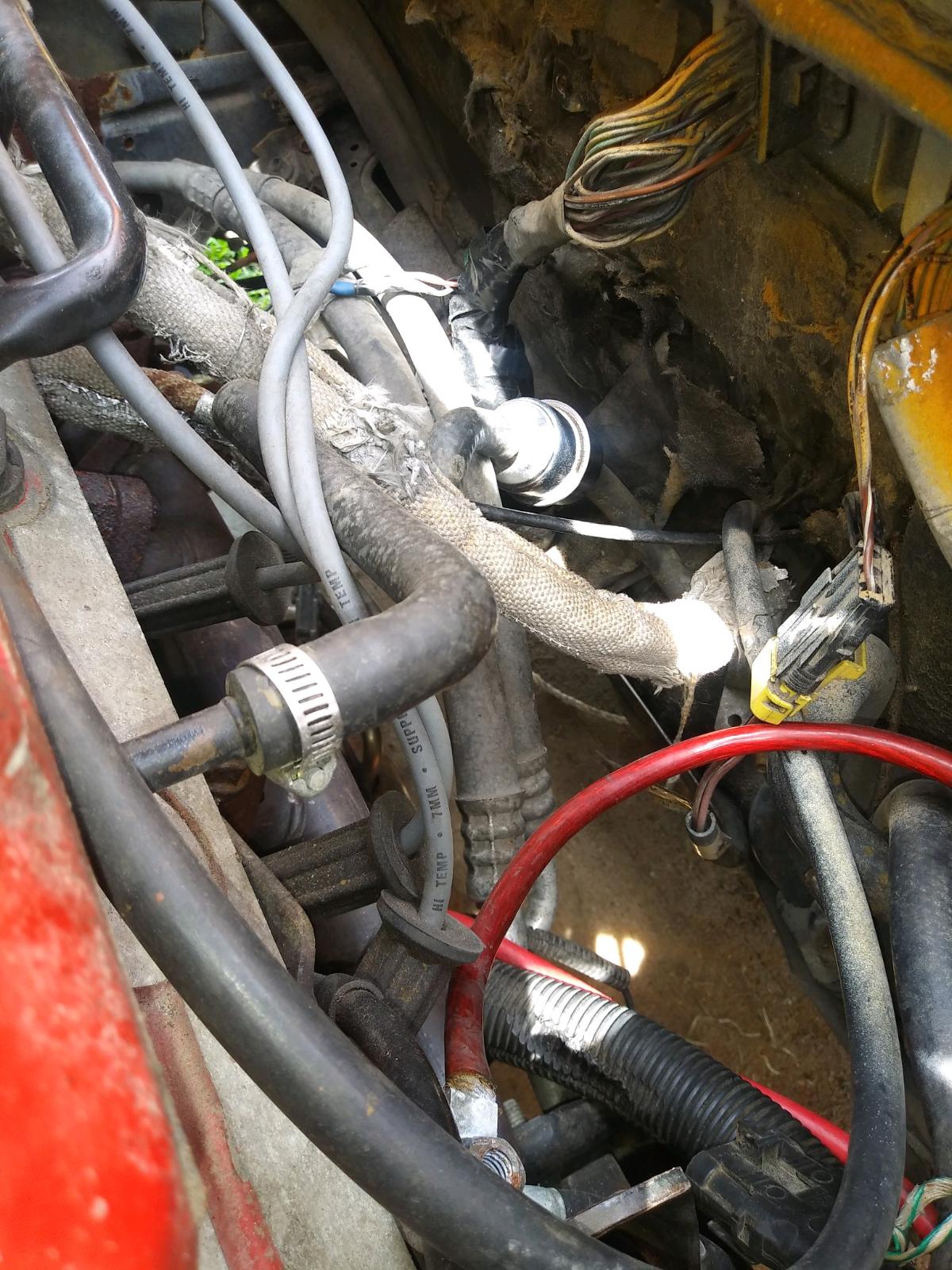

MAY 29, 10:01 PM
 [img]http://images.fieroforum.com/userimages/altownsend/Engine%20Runni ng%20Unplugged%20Throttle%20Position%20Sensor.jpg[/img]
Based on new information from this post, I ran three tests:
1) I screwed my fuel pressure gauge to the fuel rail fitting. I turned the engine over a few times and finally heard the fuel pump activate. I checked the fuel pressure gauge and there was no reading. The engine started and I looked at the pressure gauge and saw the gauge reading 45PSI. While the engine was running, the gauge went from 45PSI to 50PSI down to 40PSI at the higher RPM idle with the idle speed sensor unplugged.
2) I unplugged the idle speed sensor and the car ran for about 30 minutes at which time I turned it off. I re-attached the idle speed sensor, and the engine started buy stalled almost immediately. I unplugged the idle speed sensor, and the RPM stabilized and the engine kept running.
3) In the photo labeled "Filter of some sort', there is a filter that is attached to a hose that is connected to either the fuel rail or the intake. Can someone tell me what that filter is for (what it filters)?

No fuel pressure and it started? - yes, fuel pressure was 45PSI when I looked at it after the engine started. It could have built up as the engine was spinning.
...idle speed sensor -see photo, throttle position sensor (the one sensor on the top)
What exactly are you referring to? The idle control valve? The throttle position sensor? - throttle Position Sensor - when I unplug it, the engine runs for as long as I let it, at a higher RPM
In the photo labeled "Filter of some sort'... - the silver filter. It does not filter liquid (gas). Is it an air filter? One end goes under and into the cabin, the other to the intake plenum
