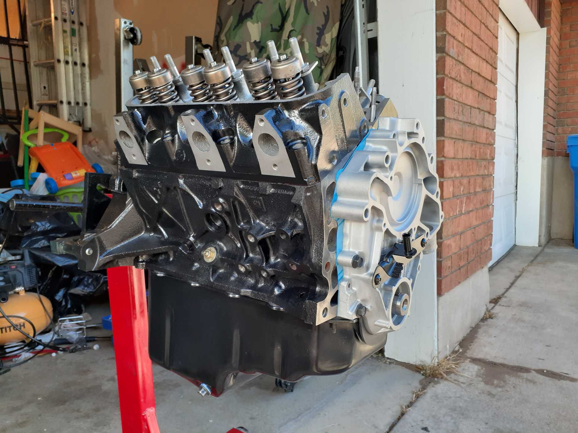

As luck would have it, I'm in the middle of my 3.4 swap and came across a donor car with the series II 3800sc. The seller says it's got 50k miles and runs great but the transmission has problems shifting. He's asking $1000, which is probably 2/3rds to half of what I have into my 3.4, but then there will be other expenses with the 3800 such as exhaust, etc.
Im kind of torn on what to do. I just got the heads back from being set up for the Crane 272 and was going to have it back in the car by the end of next week.
I would need to complete and sell the 3.4 obviously, but I have a hard time thinking someone will pay $1500-2000 for a 3.4, even if it's a totally new, upgraded build. So what do you guys think? $1000 sounds like a good deal, I guess what I'm really trying to figure out is if it's still a good deal for my situation...

| quote | Originally posted by Modesto: was going to have it back in the car by the end of next week.
Well if you're that close to the finish line, complete what you have now, drive around a bit, and decide if you want to sell the engine.
Should you decide to sell the engine, you'll be able to say it's been tested and the buyer could hear it running in your car before you pull the engine.
| quote | | Originally posted by Modesto:$1000 sounds like a good deal, I guess what I'm really trying to figure out is if it's still a good deal for my situation... |
Double that to cover the ancillary expenses, then triple the calculated time and money to arrive at a realistic figure.
Also, I see paint on the bearing surfaces for the head bolts. Clean that off with a small wirebrush on a Dremel. If the paint crushes with the force of the head bolts, the head gasket could lose compression.[This message has been edited by pmbrunelle (edited 05-22-2020).]
