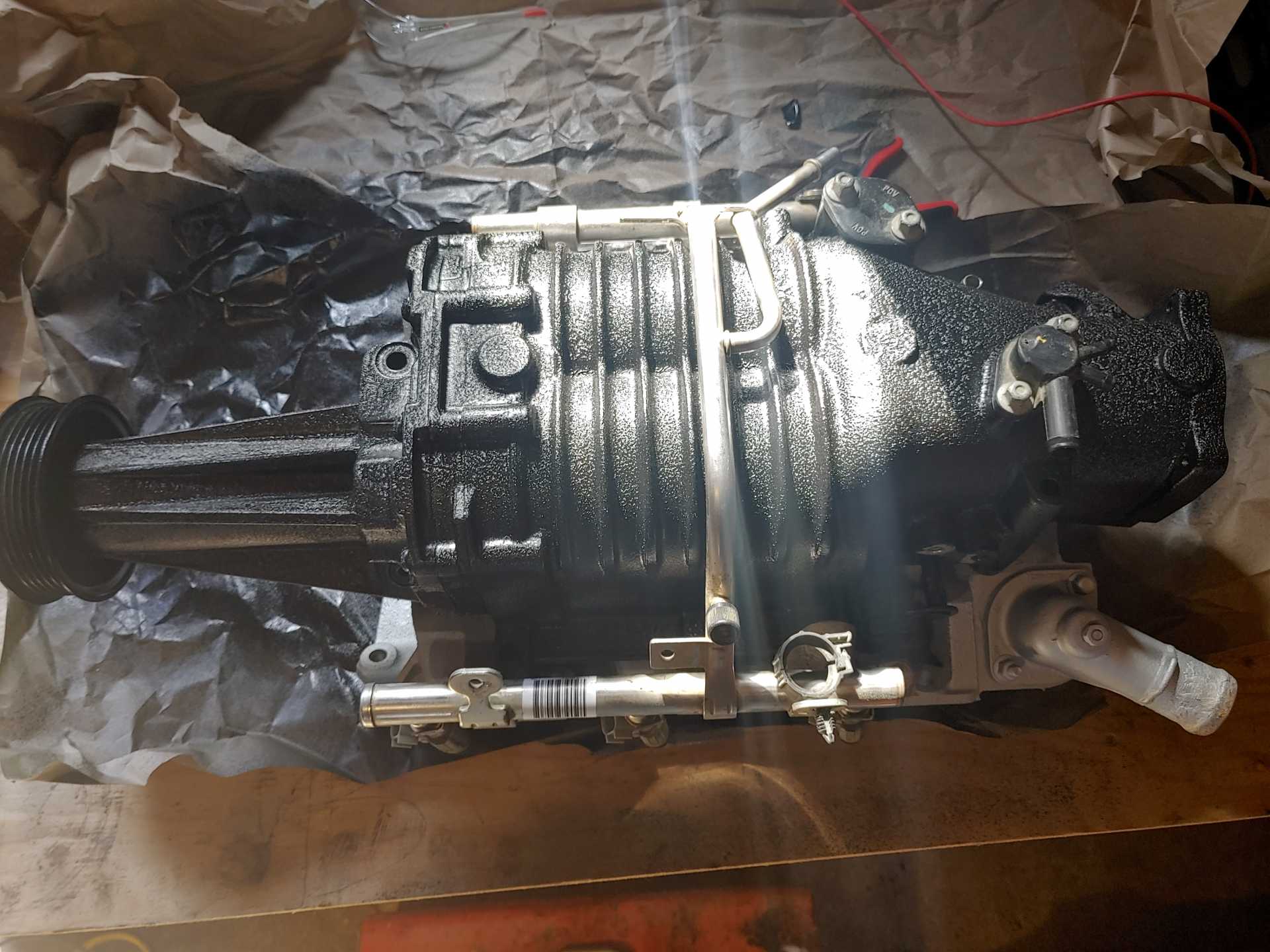

blazin' MAY 25, 06:09 PM
Little bit of progress on the SC and manifold.
Was going to paint the fuel rail, but I think I'll just clean it up, trim the extra tabs off and leave it as is for a bit of shine.
