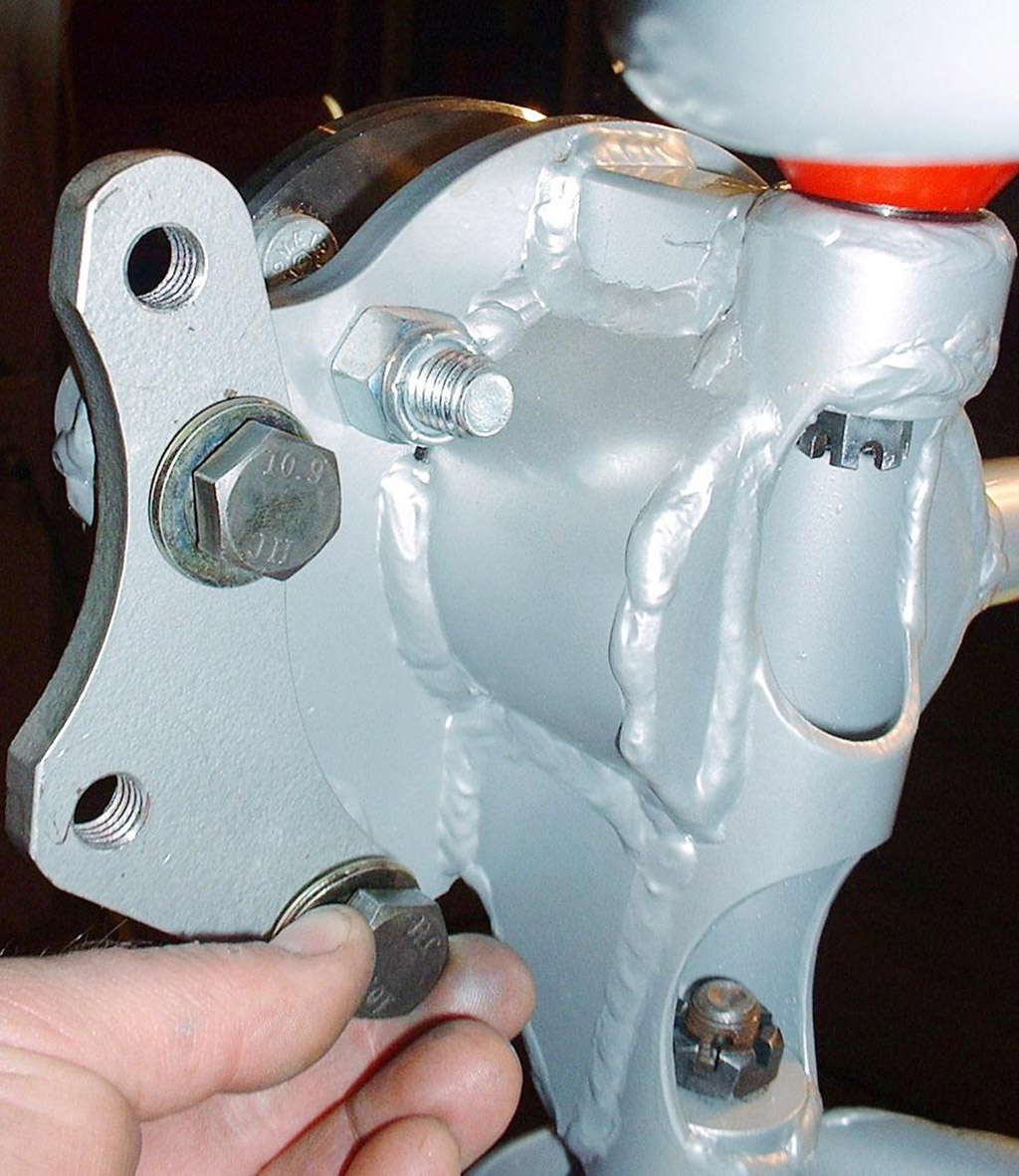

Has anyone had any problems with the Arraut Motorsports front tubular control arms? I have their front coilover setup with 1" drop spindles on my 88 Mera, After seeing the broken spindles, mine have the extra lower brace like this one, I think I will put the OEM spindles back on the car. I would like to keep the coilover set up, I would appreciate others thoughts about keeping the control arms made by Arraut.
IMSA GT
MAY 16, 10:39 AM
I've never heard of any failures with the front arms, just the spindles. However if you saw the other thread, the OP now had the REAR fail on his 88 which pretty much destroyed the car.
Personally, I would leave the coilover setup on the car, put the stock front spindles on and get Rodney's 1" lowering ball joints.[This message has been edited by IMSA GT (edited 05-16-2020).]

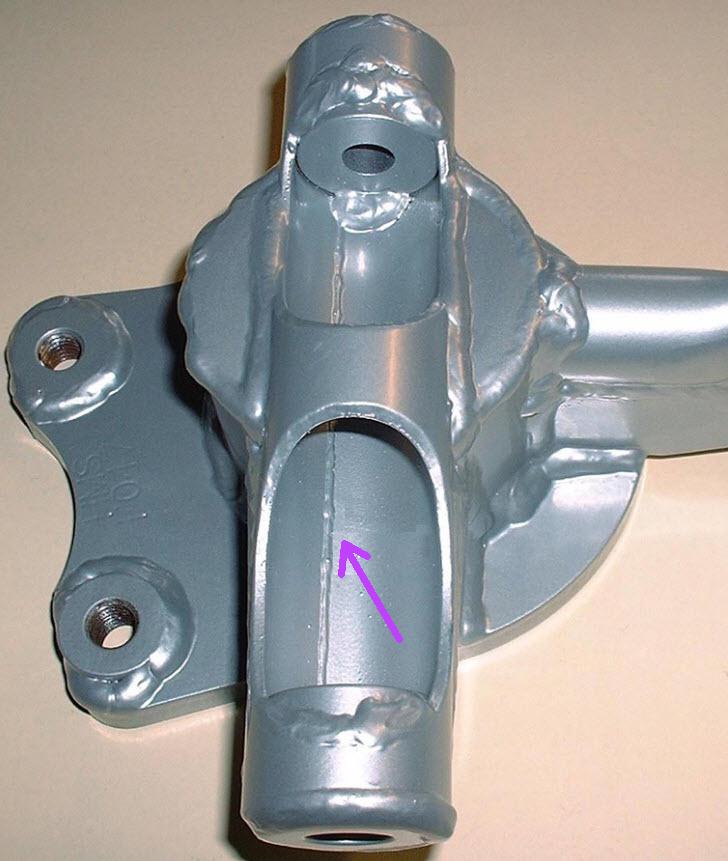

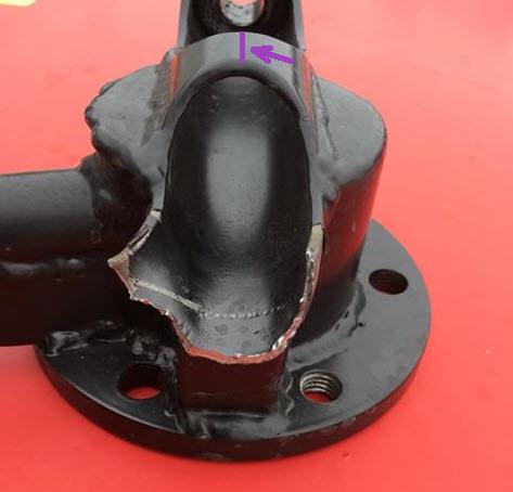

IMSA GT
MAY 17, 02:13 PM
If you have the same style as Dave which was the Held design, you should be fine. It seems Arraut rushed the assembly of the spindles and used a few shortcuts.
I posted this in another thread but I believe this is the cause of the failures.
With Daves spindle from Held, the weld seam is on the outside where all of the structural welding and gussets are.
 On the spindle that broke, there is no seam to the outside which leads us to believe that they welded the parts with the seam inside towards the car. That would mean that the seam had no support and could easily split open under stress especially since the seam would run right through the cutout for the nut. In this pic, here's where I THINK the seam is located under the powdercoating:
 [This message has been edited by IMSA GT (edited 05-17-2020).]

| quote | Originally posted by Larryinkc:
I personally wouldn't trust my life to any part with welds that looked that way. They may be good welds and maybe they aren't but they look awful.
