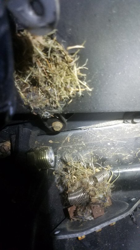

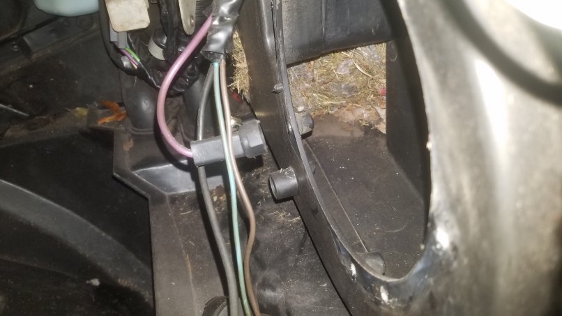

Just a friendly reminder to check on your blower resistor. Don't put it off thinking it's a rare issue or doesn't apply to your car. Here's two images of what I just discovered in mine:

Looks like inside of a hay baler...
http://www.fiero.nl/forum/Forum2/HTML/141959.html
or search blower resistor fire
Is not just a "Fiero problem" either. GM Ford and many others use same method to set blower speeds for Decades.
Newer cars have 1 or more Thermal "Fuse" and "Screens" to stop crap in the resistors but don't trust them.
Often All it take is a spark or small cinder blowing off the resistor pack to light up crap in heater/ac box of many vehicles.
