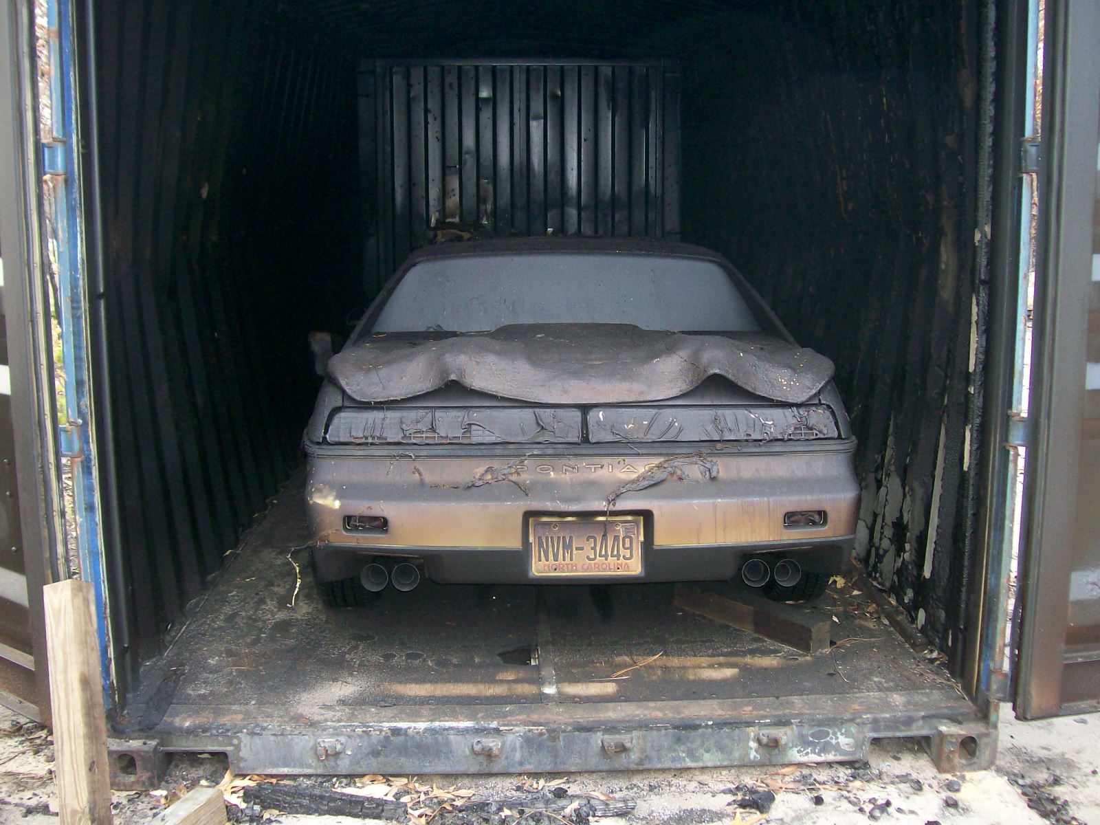

I had an '86SE for 22 years. I loved it. I would still have it had it not been destroyed in a fire.

Wow! Ouch! Sorry for your loss.
