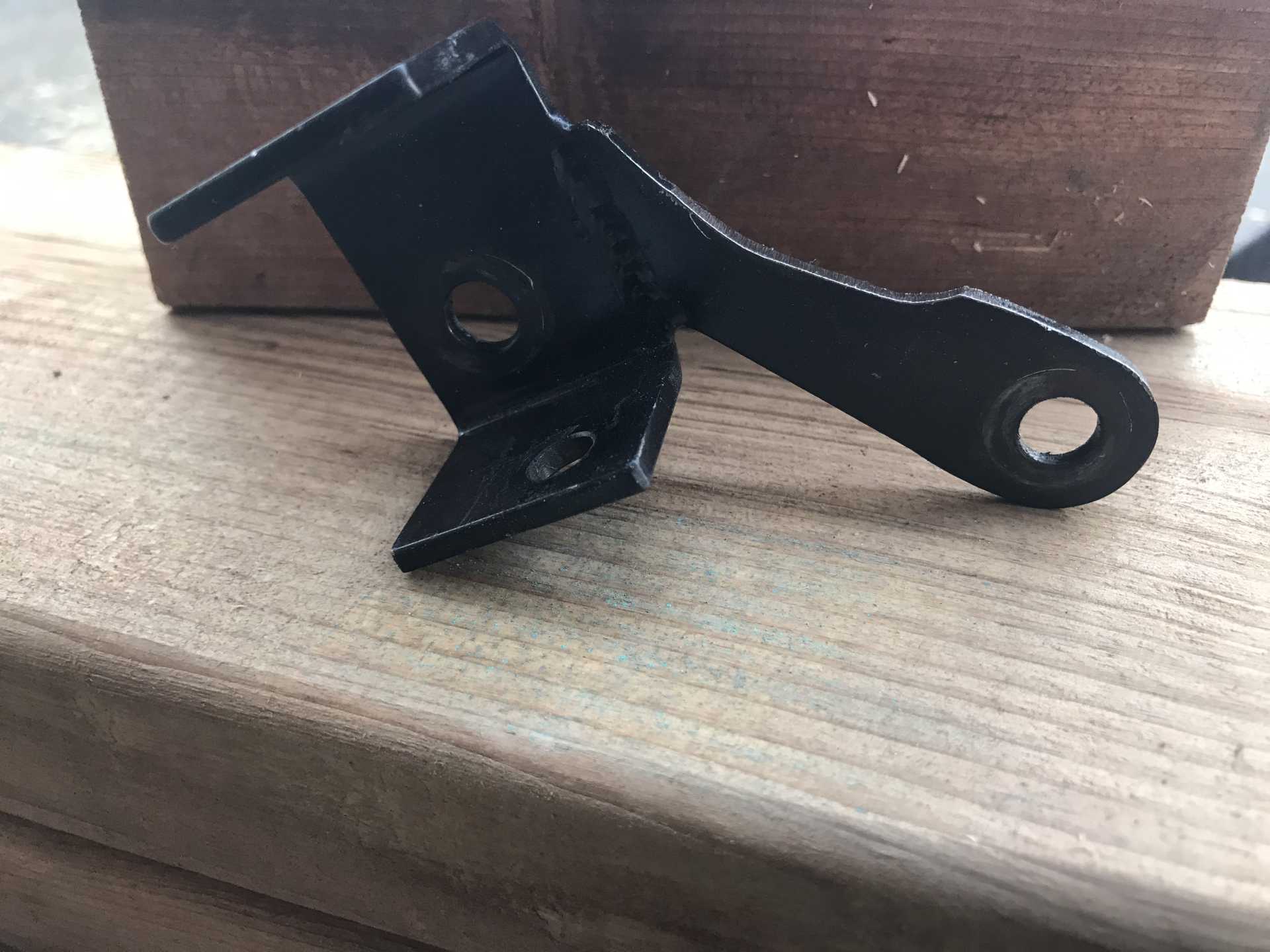

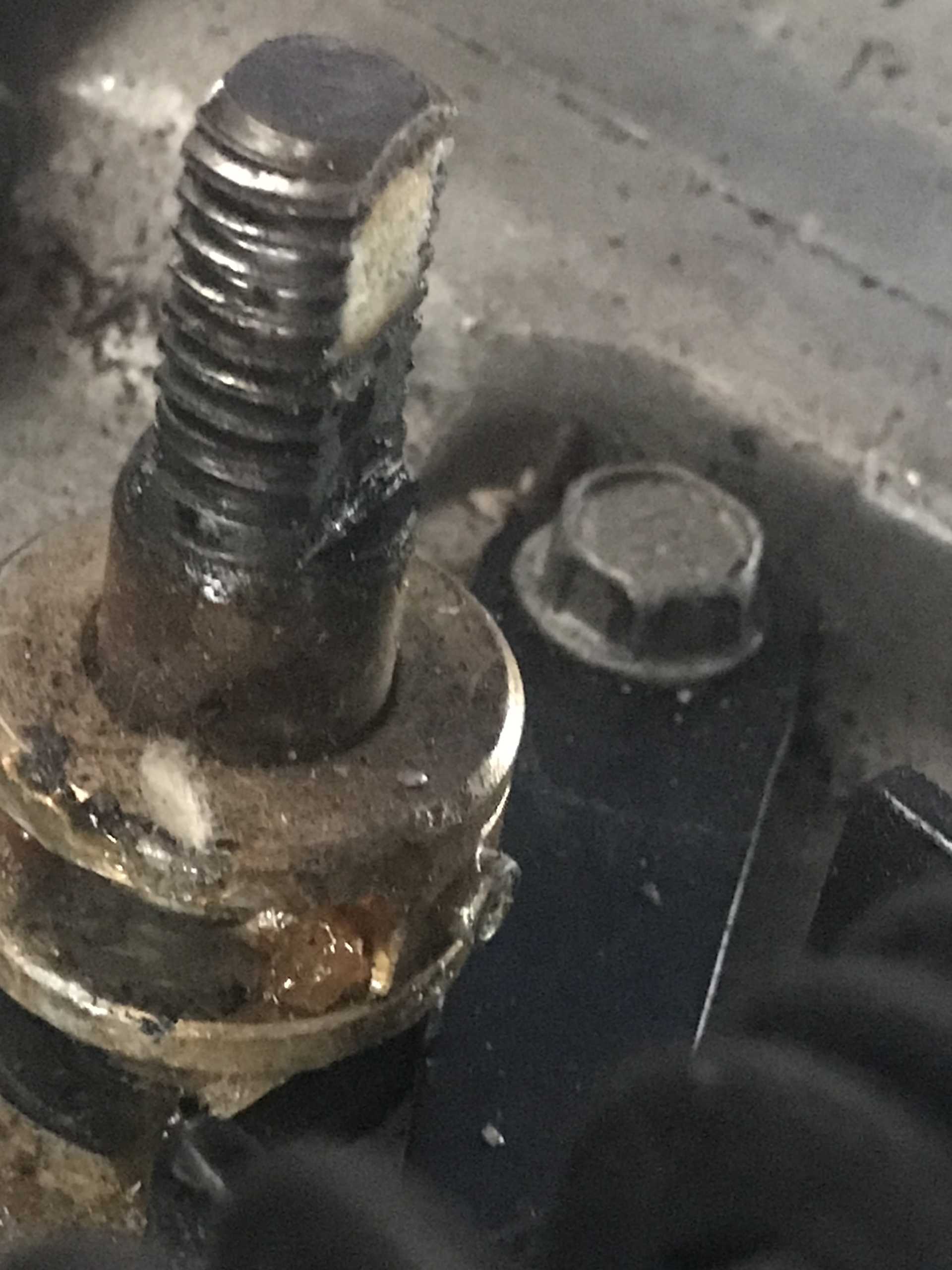

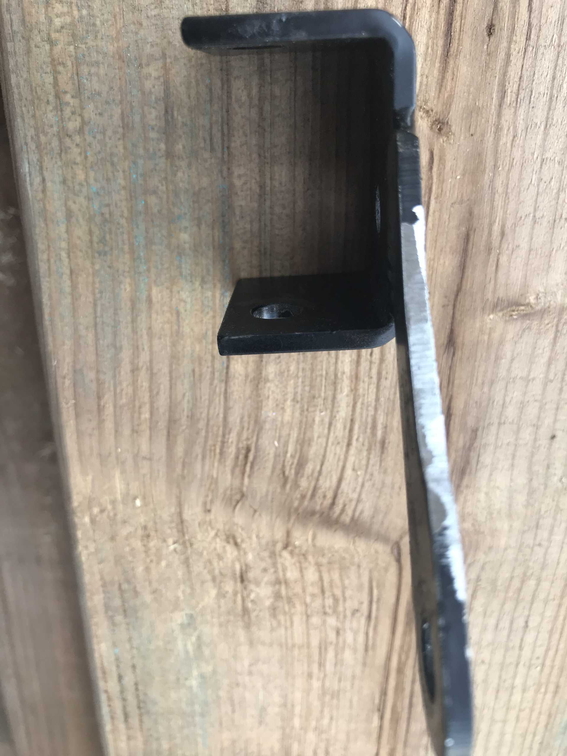

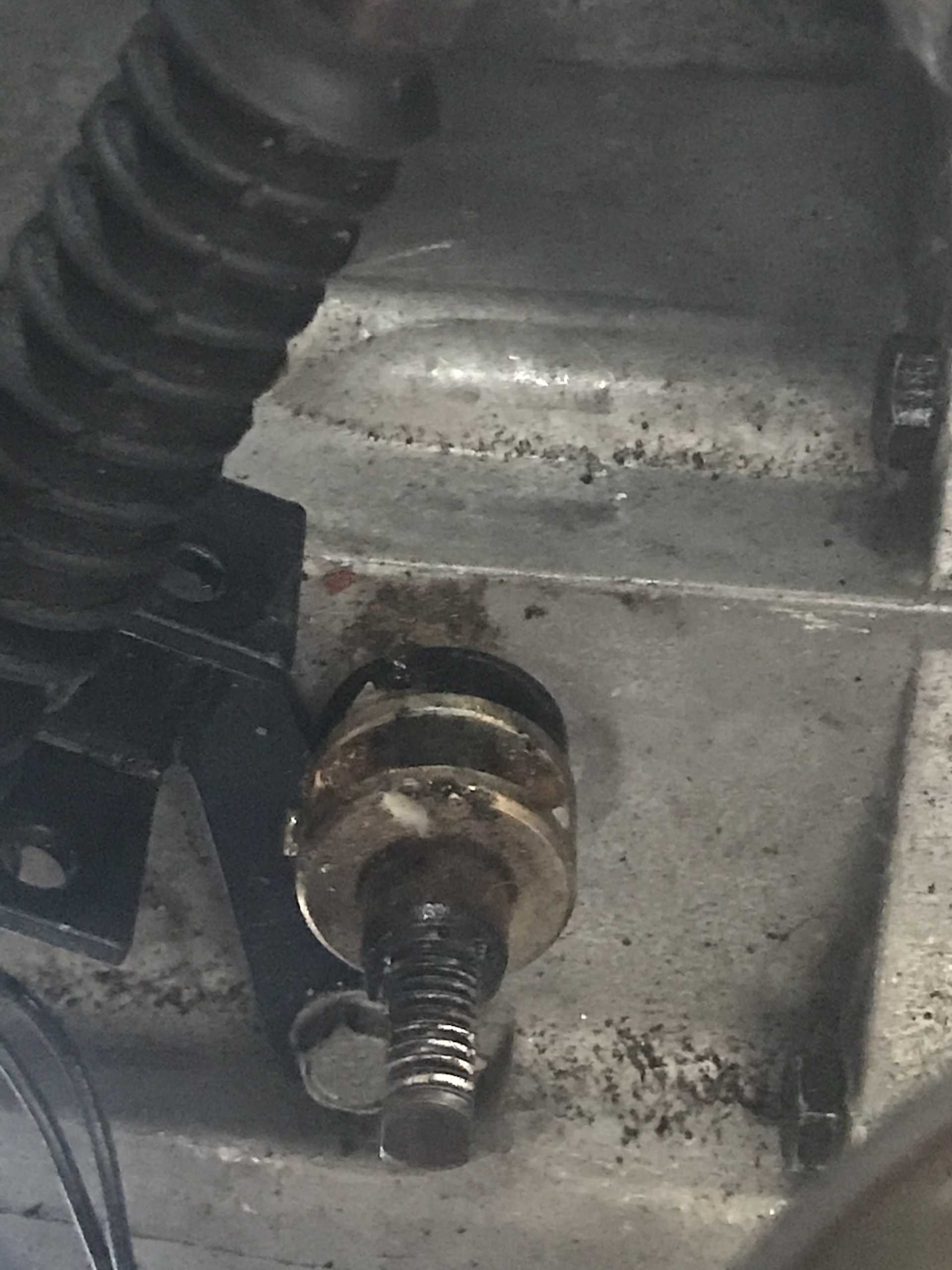

I went into and read ytzman’s posting to try and make sense of what had to be done to get the HM282 FWD off eBay to shift into all gears. Rodney has an update on this part on his web site stating you may have too make a mod to this part for this transmission or you may not get 5th & reverse but my issue was not getting 1st gear and had all others. So this through me off. Not sure if this modification fixes multiple issues? But here is what I did.
I took a look at the FWD conversion purchased from Rodney and how it was possibly making contact with the shift rod bushing, once I could see the issue I etched the paint on the bracket with a drill bit around the collar(By the way amazing products from Rodney and a huge shout out to him for making these amazing products - I have bought a lot over the years and I’m never disappointed!).
I then removed the FWD conversion kit along with the shift cables. Took my bench grinder and followed my etched line to remove the excess material(I removed more than 1/8). Repainted and reinstalled kit
I then aligned the shifter with a drill bit and attached the cables.
Tested it and I have 1-5 and reverse!
I attached pictures for anyone willing to attempt this transmission in the future.
Before you do make sure you have all the proper tools before taking apart and make sure you measure your original reverse shift rod with a straight edge along the case and measure the new one and cut and the same as the old one. Bolt the case back together with anaerobic sealer to proper torque and make sure the shift detents are in correct location and transmission is in neutral and secure detent block. Seal the hockey puck back in place and tranny is done and ready for install. Good luck! It took many attempts for me to get the right.
See pictures for Rodney’s FWD kit with the small mod that needed to be done to get all gears.
