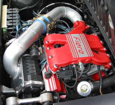

Came across this and made me think of the 2.8 install. All I know about it is that the mfg closed up shop back in 2007.

It's funny because for the life of me I can't remember what car used that setup back in the late 80's. I thought it was a great way to remote the supercharger. I had to search for this but back in the day one of the members from Germany engineered this:
I thought it was a hell of a setup.....and a real headache to engineer.

That engine has an extra-long dogbone to push the engine forwards and away from the trunk, presumably for supercharger clearance.

I think it may be Mercedes, I had a friend who worked at Mercedes and he showed me a blower that was offset like that. Google "Mercedes supercharger" and look at the images.
I thought it was a hell of a setup.....and a real headache to engineer. |
I'm curious if this set up is still on the road or if he blew up the 2.8 ...

I have a friend who has a 2.8 in his Manx dune buggy. And it is supercharged. He has told me about it in the past and my vague recall is that it was an aftermarket unit used in S10 pickups as I recall. When he sees them or associated parts on EBay or elsewhere, he tries to buy them. He has mentioned to me that he has a complete setup that I should be using on my Rokit mini wide body. He doesn't seem to have issues with the setup, and brings the buggy to our car shows and on some of the tours we do. I can get more info if anybody cares.

Fageol made a S/C kit intended for S10 2.8L engine applications. https://img1.wsimg.com/blob...oads/fs-S10_info.pdf
Pics http://www.fiero.nl/cgi-bin...ad=20110502-2-106764

If you consider the ease of installation, cost and performance , the turbocharger wins on all counts. All it requires is some custom exhaust work, an simple oil line, a 2 BAR MAP and a custom chip, but the stock 2.8L engine is not a real good candidate for anything more than 5-6 psi of boost. ------------------ " THE BLACK PARALYZER" -87GT 3800SC Series III engine, custom ZZP /Frozen Boost Intercooler setup, 3.4" Pulley, Northstar TB, LS1 MAF, 3" Spintech/Hedman Exhaust, P-log Manifold, Autolite 104's, MSD wires, Custom CAI, 4T65eHD w. custom axles, Champion Radiator, S10 Brake Booster, HP Tuners VCM Suite. "THE COLUSSUS" 87GT - ALL OUT 3.4L Turbocharged engine, Garrett Hybrid Turbo, MSD ign., modified TH125H " ON THE LOOSE WITHOUT THE JUICE "

I keep seeing ideas for superchargers for the 60 degree V6. The narrow intake manifold, due to the narrow angle between the banks, seems to be the limiting factor. I keep wondering if the injectors and fuel rail(s) couldn't be mounted inside the manifold, under the supercharger, similar to how the 4.3 Chevy CPI setup is done. It would allow a lot more flexibility in mounting the S/C. Even on top of the engine. I don't think a few pounds of boost would be much of an issue. The heat generated might be, however.
Thoughts?[This message has been edited by Raydar (edited 05-06-2020).]
