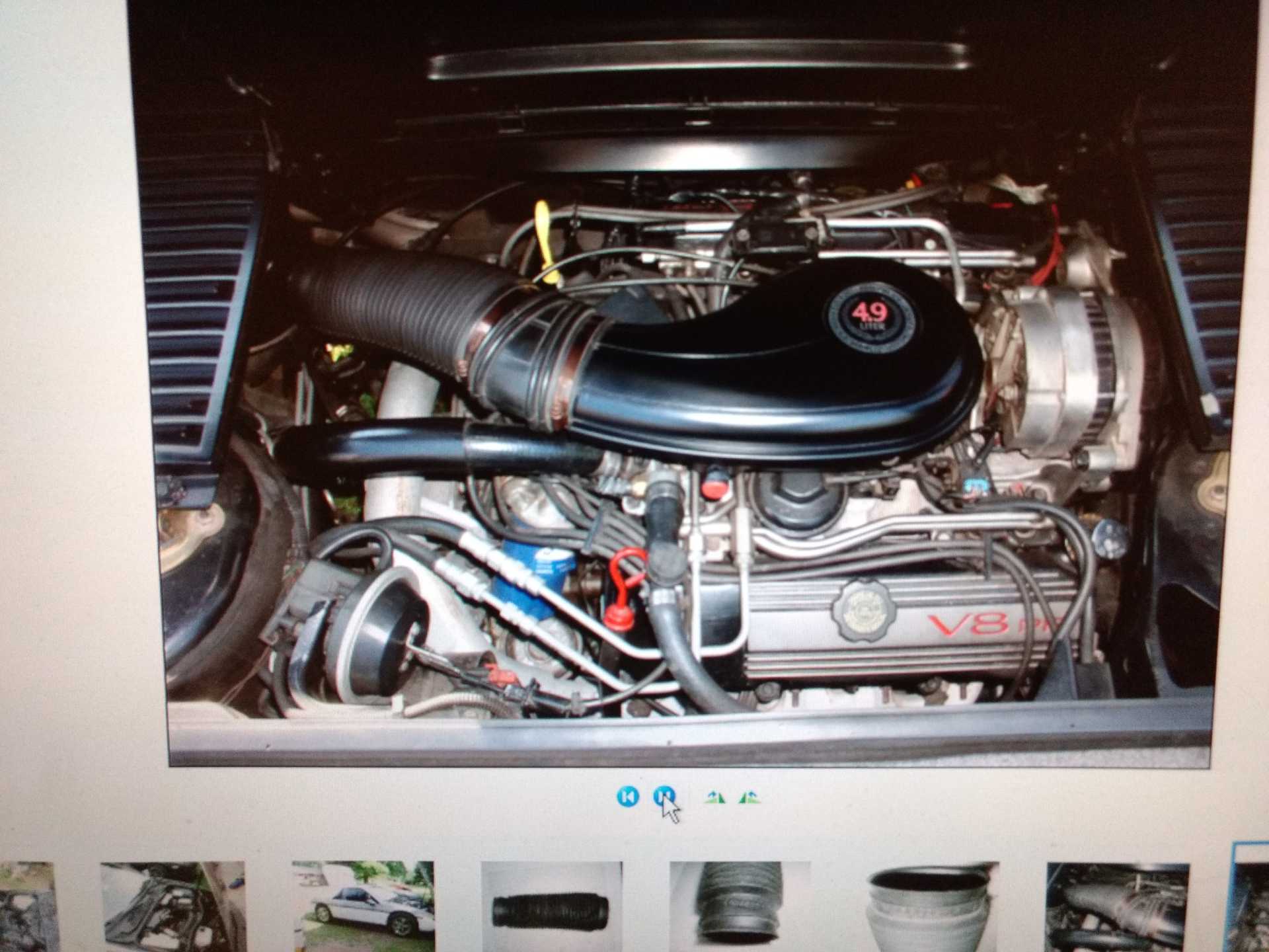

Hi all, first of all, hope all are staying safe.
I need this part shown in the green outline in the photo below. Does not need to be as nice as that one "if possible I'd like it to be" however just knowing what hoses to get would be fine as well.
Thanks in advance to any and all who can help me locate these parts or hose/hoses.

You can plug the hole in the air horn and install a vent filter in the valve cover grommet.

I appreciate it. So there is no issue in plugging the hole in the air horn, correct?
APR 28, 08:50 PM
No problem. The tube is the filtered air feed for the PCV system.
APR 28, 10:27 PM
My 4.9 came with a similar setup. I swapped to a small "cone" filter on the valve cover. No problem at all with plugging the hose barb on the intake duct.
APR 29, 05:58 AM
I believe this gives a clear shot of the mod that we are discussing.[This message has been edited by Dennis LaGrua (edited 04-29-2020).]
Can I ask what the Intake hose is from that you used to go the 4.9 intake? I haven found an acceptable hose that works worth a crap, other than dryer venting.
thanks.
Dan
MAY 01, 07:00 PM
That is a Camaro duct, from a HO 305. If I can find the part number, I will post it here.
