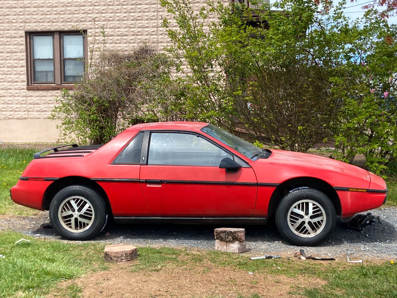

IT'S ALIIVEEE. ITS ALIVVEEEE That's right! It's running, it didn't run for long due to the fuel leak, but it runs.| Listening to the advice on the previous post, it was in fact the clutch being low. I will be replacing that so I can atleast start it without bypassing the switch every time. other tid bits. Put brand new tires on it, tried to get the caliper free , but it seems the bottom bolt is really stuck on there. any suggestions on how i can remove that? other than that, progress is going great!
