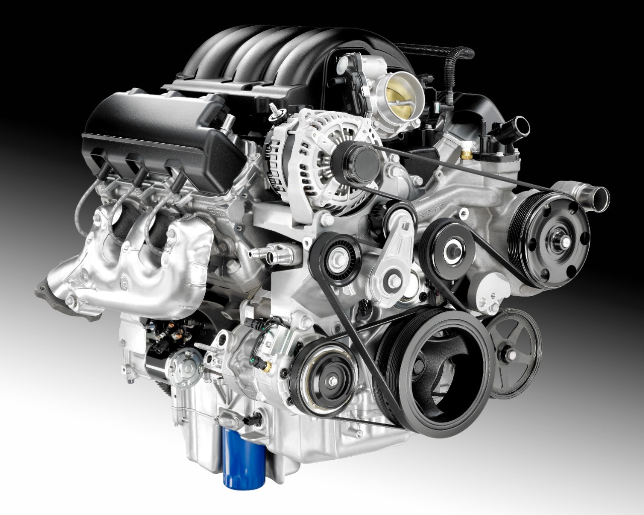

I searched the 4.3v6 and found an all aluminum version in the Silverado. Is this the engine you are talking about?

I searched the 4.3v6 and found an all aluminum version in the Silverado. Is this the engine you are talking about? |
Yes- That is the one; The LV3. The beauty of it is that it is almost 100 lbs lighter than the LS4 V8 but has almost the same power...and will sound like a beefier "Fiero V6".....Yes, you would need the bellhousing adapter plate, and have to play with the electronics to run right without a BCM, etc.
