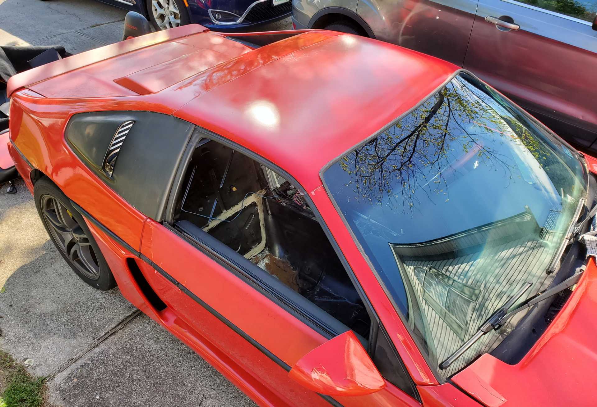

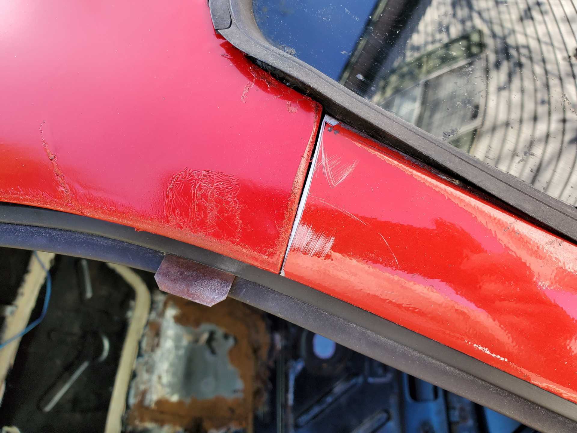

so I've wanted to remove the sunroof from my 88 GT for some time now. I had bought a hardtop from a friend a few years back but on the way home it fell over in my truck and the clip cracked at the top of the "A" pillars. I decided this weekend I was going to swap out the tops. First I cut the ragged ends of the HT clip and then made a template to match the shape on the SR clip. Then using a thin coping saw I cut a straight line from the template. I removed the SR top and gave it a test fit. only off by a mm or so, shaped it with some sand paper and perfect fit.
Now I know its not the best way to do it. But it took me a long time to find a good condition hard top, and even after I had broke the "A" pillars it was still a good top, no delamination and no cracks. I plan to cut a "V" into the area where the two meet, and for now fill it with some SMG, later i'll glass the two parts together but for now it should work.

What was the final straw in moving you to action on this? Leaking?
qwikgta
APR 08, 04:38 PM
it suspect it was leaking but not from the gasket, it would not fit tight at the glass, i just could not get it to seal tight. I asked if there was anyway to get the top to fit better, but never really got an answer. I was not a fan of the sunlight coming in from above and I had put some 3M vinyl on the glass, it was the same color red as the body. I guess the final nail was when I went to redo my stereo system, I wanted to remove the factory Sub-woofer as a complete unit, and had to take the headliner down to get it all out in one piece. Once I had the headliner out I figured why not just go all the way. Cutting off the A pillars was not difficult and in the end I just like the car w/ out a sunroof. I guess I'm weird b/c I also like the GT w/out a rear spoiler too.
