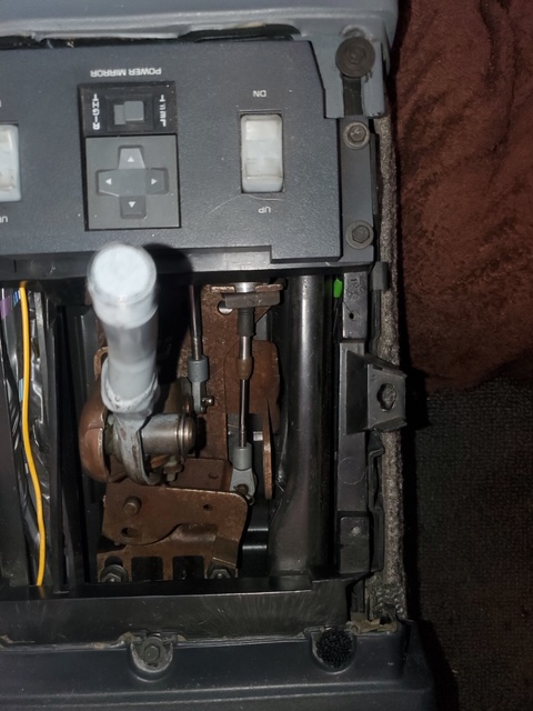

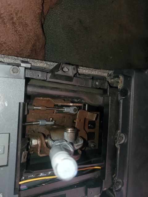

Can you post a picture of the shifter assembly with the center console removed? I am pretty sure it is a modified 4 speed, but If want to see if the cable sleeve mount position was moved (DIY modification to use 2 getrag select cables - which have been prone to buckling and breaking the shift cables). Depending on how the shifter was modified and the cables used, you might want to consider changing it to a more durable setup that uses a stronger shift cable.

cam-a-lot
APR 07, 08:29 AM
Shifter pics.
Comments?
