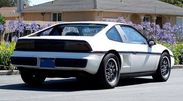

My 1985 SE V6 has 16 x 7 - 38 mm offset wheels (VOXX Monzas- no longer avail) The tires are 205/55 and 225/55...These sizes were used on a number of popular cars so they are readily available from many manufacturers and different styles/performance ratings- I prefer General G-Max AS-05s because they are A) Highly rated, B) All season, and C) Lighter than most other brands.
Light weight will make a difference in the feel and performance of the car. I switched from some 15 x 7 Eagle-Racing wheels and BFG tires in 2007 and lost 3 lbs of each back wheel and 6 lbs of each front wheel...The difference in feel was impressive......Performance gain can be stated as; 40 lbs off of wheel/tire package equals 200 lbs off of vehicle weight. Think about this; My Fiero performs well with just me, but my friend who weighs 190 gets in and the car really loses it's edge.
Here is a pic of my car with the VOXX wheels and G-Max tires;

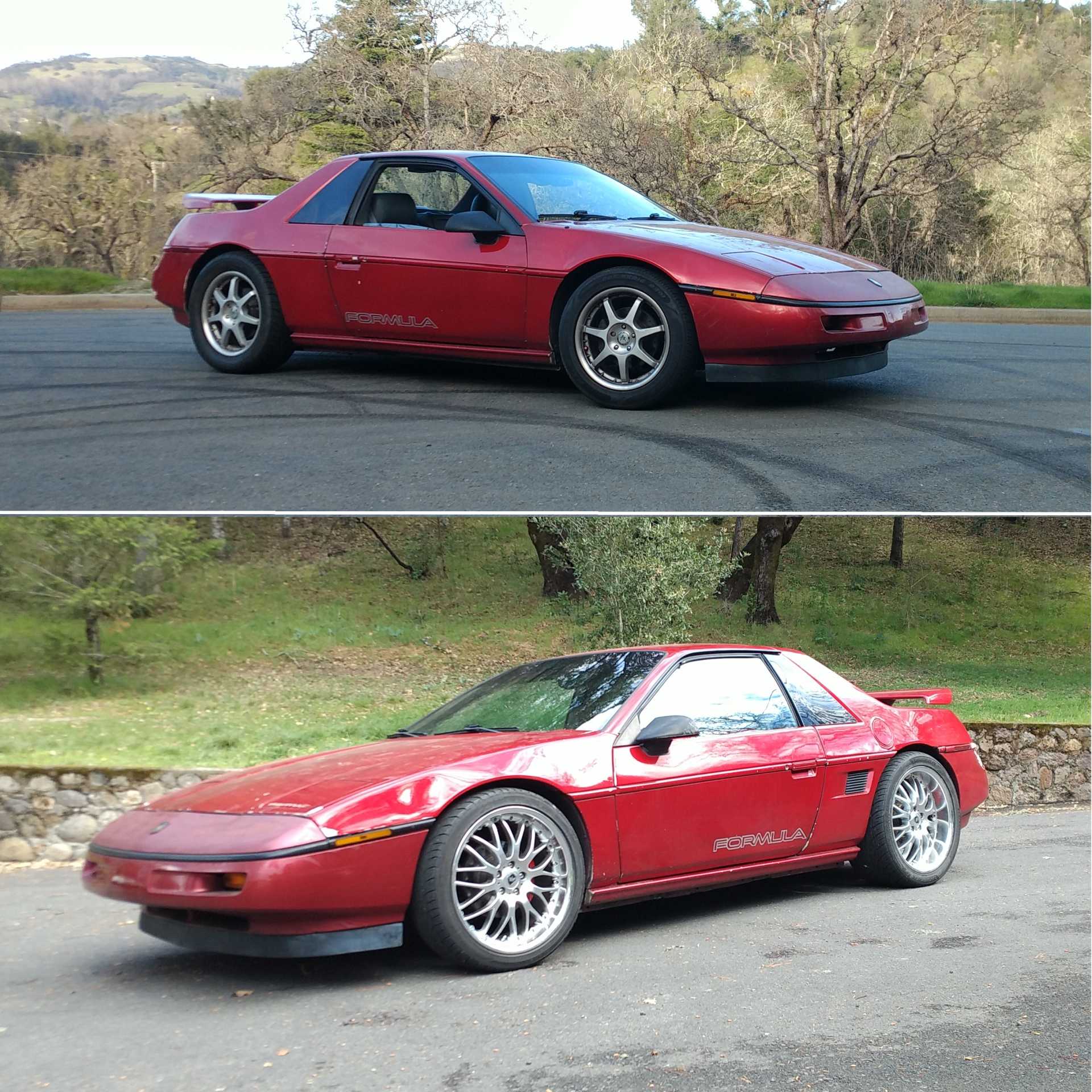

Top are American Racing 42mm offset 16x7 with 205/55/16 Front and 245/50/16 Rear.
Bottom are Monarch 35mm offset 18x8 front and 18x9 rear. 225/40/18 front and 275/35/18 rear.
Edit: By the way, if anyone is interested, the top set with tires is for sale in the mall: http://www.fiero.nl/forum/Forum4/HTML/078463.html[This message has been edited by liv4God (edited 03-16-2020).]

Do the front's stick out at all? And do you have any clearance issues with the 275's in the rear? Any pictures of the rear or front angles to show how they tuck in?
Car looks great!!

| quote | Originally posted by Rare87GT: Do the front's stick out at all? And do you have any clearance issues with the 275's in the rear? Any pictures of the rear or front angles to show how they tuck in?
Car looks great!! |

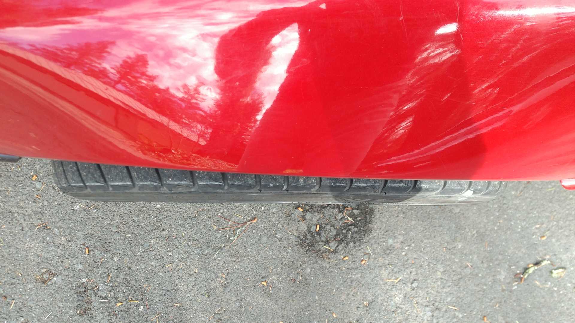

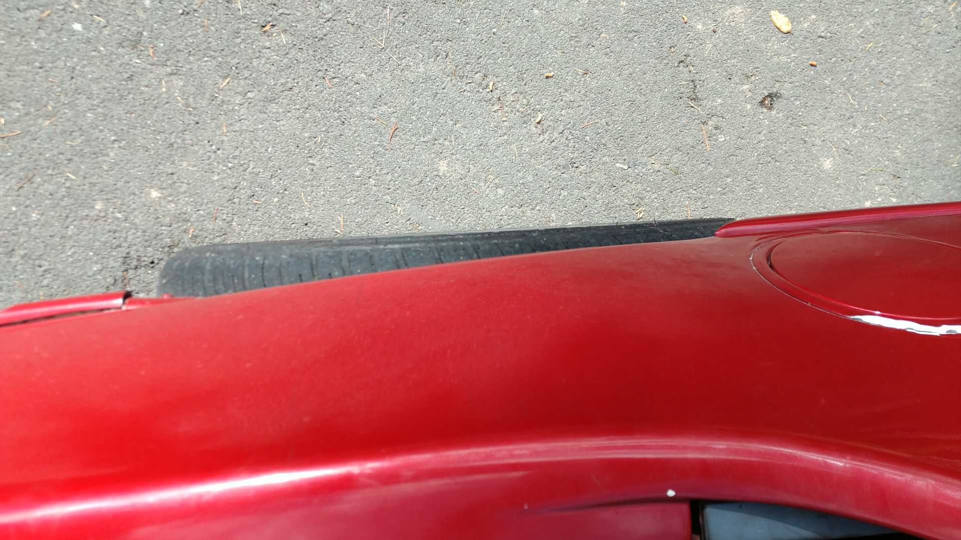

The Wheels do stick out a bit, maybe up to an inch. Not far enough where it looks bad or needs a wide body, but definitely not flush either. The 275 does not seem to be rubbing anywhere and appears to have room to fit 285s Front from above:
 Rear:
The 42mm were flush, even a bit under in the back with stock width tires. The wider tires made it more flush in the rear too.
38-40mm would probably be best if you don't want anything sticking past the fender.[This message has been edited by liv4God (edited 03-16-2020).]
