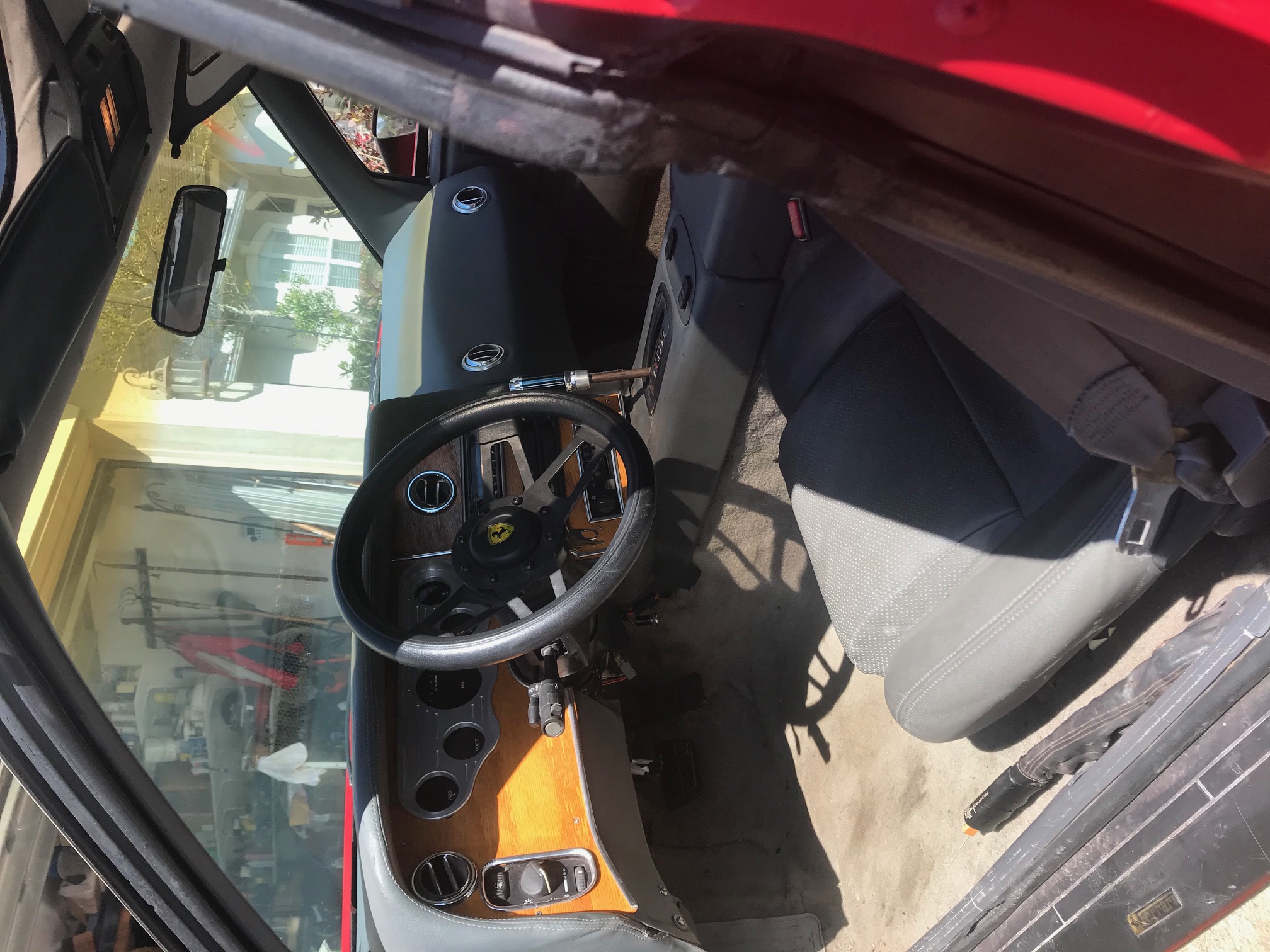

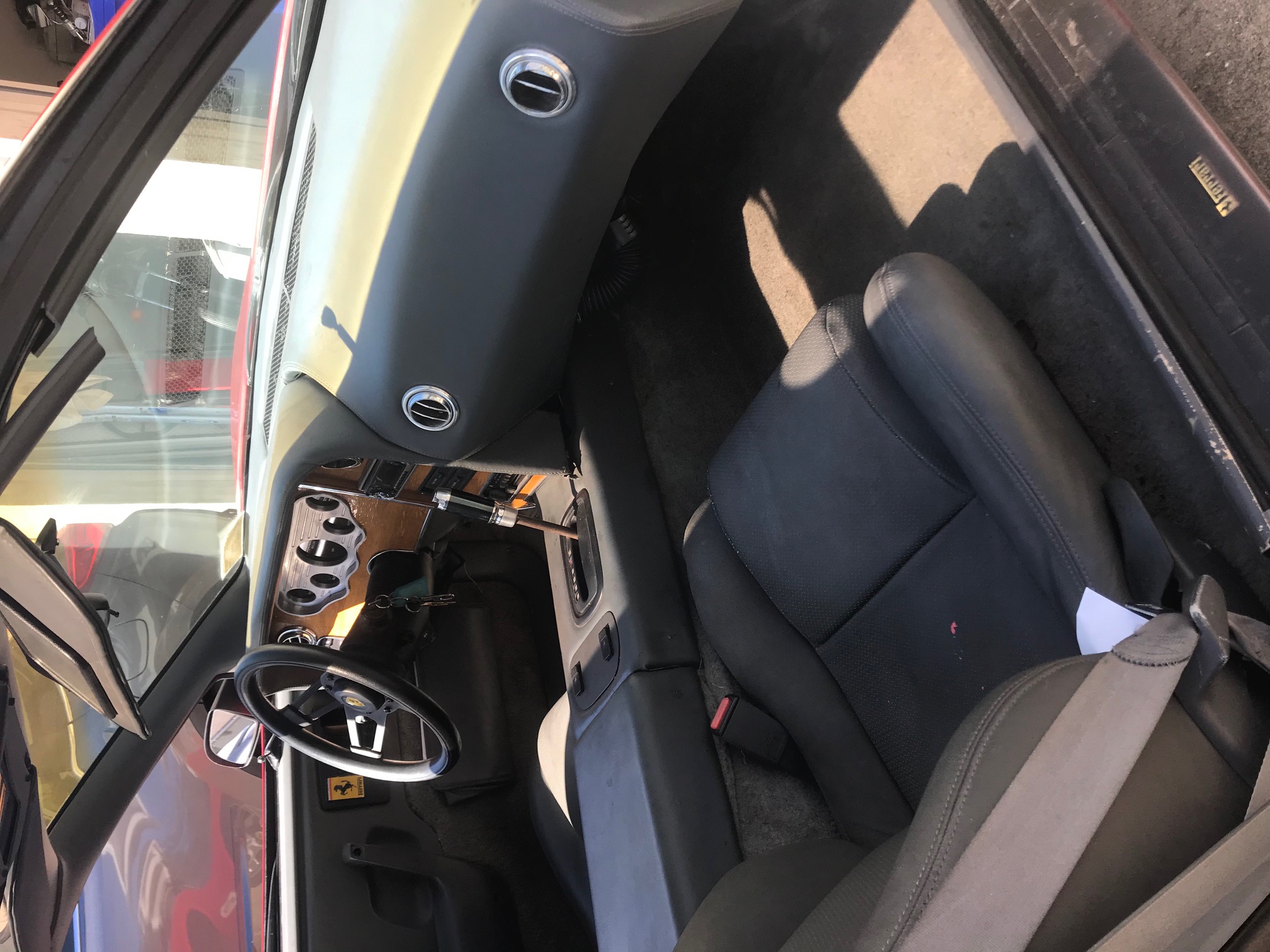

Euro style dash, no idea where it came from. You have to love the wood grain dash cover yet they installed Dakota Digital gauges; has less than 400 miles on odometer. Wood will be recovered in carbon fiber.
Interior smells like gear/motor oil. Took it for a ride yesterday for an hour or 2 and couldn't get the oil taste out of my mouth. Carpet is likely trashed, dash shows signs of strain so will need to be recovered and stereo doesn't work. Seats were recovered but drivers show rub wear on left side.

Looks like a Pisa dash cover. Car looks nice, thanks for posting. ------------------ 86 GT built 2.2 ecotec turbo rear SLA suspension QA1 coilovers on tube arms

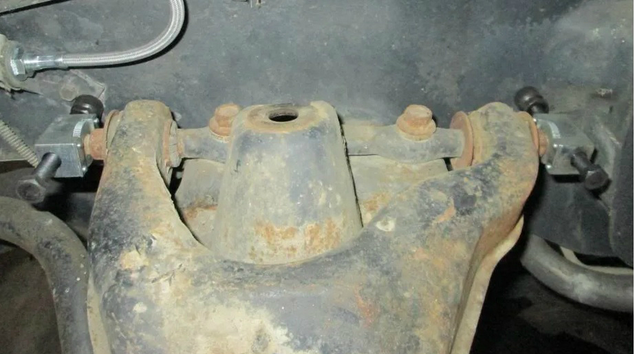

Most alignment shops have never seen a Fiero and probably won't know how to properly set the front caster and camber. The upper A arm pivot shaft has ridges on the underside that bite into the frame to hold the shaft in position. You need a set of Kent Moore J-36419 tools to keep the shaft in place while the mounting bolts are tightened. They show up on Ebay occasionally.

Fix your pictures, they are all sideways.

I'm not sure why pictures showed up sideways as they were taken in normal mode.
