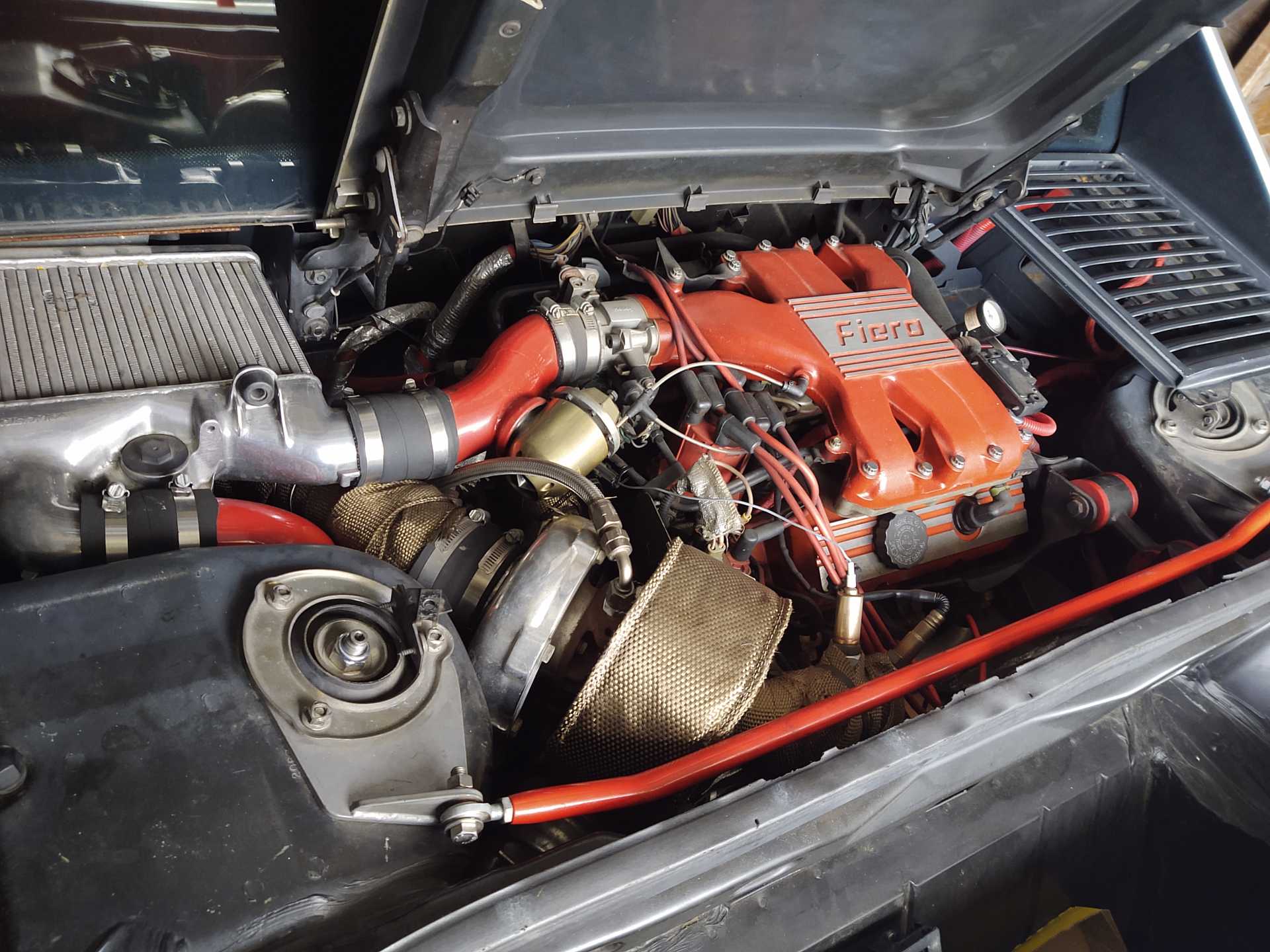

First off I lied. I'm going through the stack of paperwork and it would appear I have forged pistons at the very least. I know the injectors have been balanced but I'm not seeing anything as far as what it's got so I'll continue to look around I have more than an inch of paperwork and there might be more someplace else also... Took a pic just for the general idea of what we're looking at. It's not possible to be making 215hp on stock injectors right?
wftb
DEC 05, 12:35 PM
With stock injectors running 10 lbs of boost the person running the dyno would have shut it down before he could get any readings I would think. It would knock badly. ------------------ 86 GT built 2.2 ecotec turbo rear SLA suspension QA1 coilovers on tube arms

I have another random idea that could be fruitful... In addition to all of the various things I'll be finishing up this upcoming spring I'm also considering rotating the intercooler into a vertical orientation. Removing or cutting the deck vent to fit. I just feel like the size and placement is less than ideal and even if I just reconfigure it's placement and not swap to something bigger or water to air it'll be more effective. Thoughts?

I would just drive it as is and see how you like it. The only way to judge an intercoolers effectiveness is to monitor charge pipe temperatures and then make changes as needed. If you have a stock ECM you may not have a knock sensor (I think only 85 model years had one) . Trying to make big power without a way to monitor KR and temperatures can be disasterous. Everything looks clean and well thought out in the engine bay. You could easily change out the air to air for an air to water intercooler, the HX would sit in the same spot and one to fit the piping configuration is probably available. I got all my intercooler stuff from frozenboost.com . As far as E85 is concerned, unless you are looking to make max power I would not bother. Your mileage will take a big hit and the Fiero gas tank is small at 10 us gallons, so you will get not much range out of a tank.------------------ 86 GT built 2.2 ecotec turbo rear SLA suspension QA1 coilovers on tube arms

Air travels up through the decklid vent, so right now your intercooler is oriented to be cooled by the airflow.
The intercooler presently appears to fit well with those custom red pipes. I don't think I would mess with a good setup without good reason.
