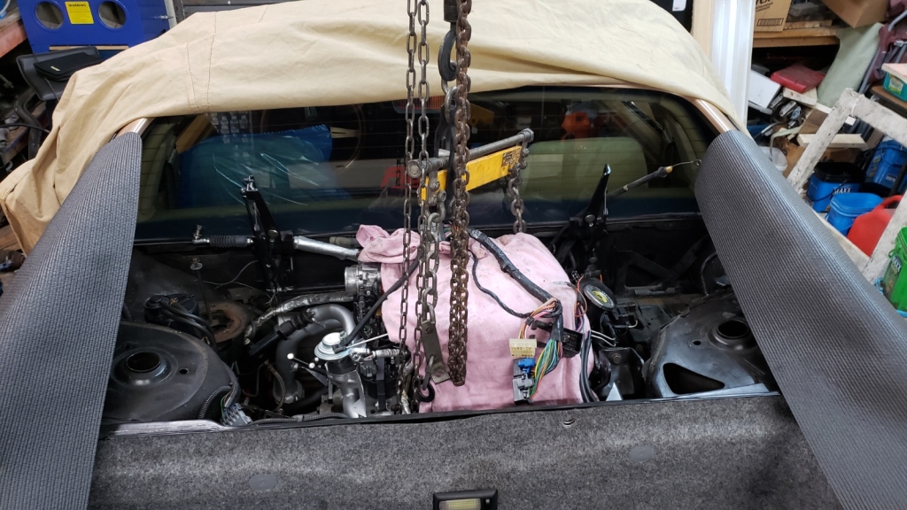

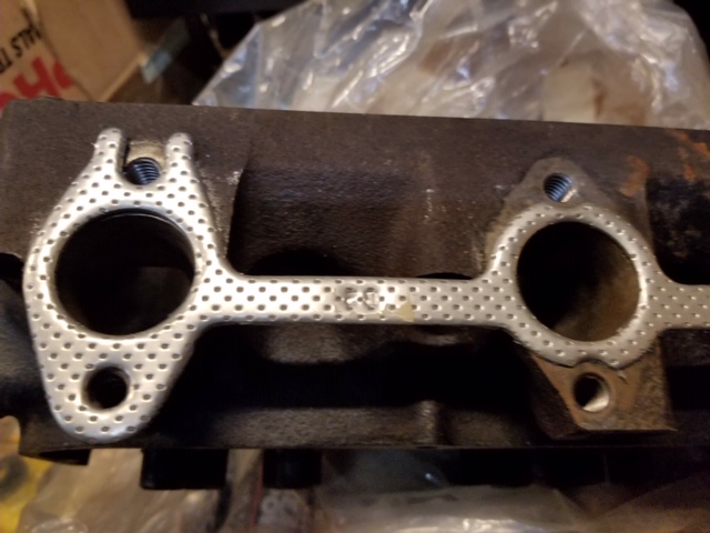

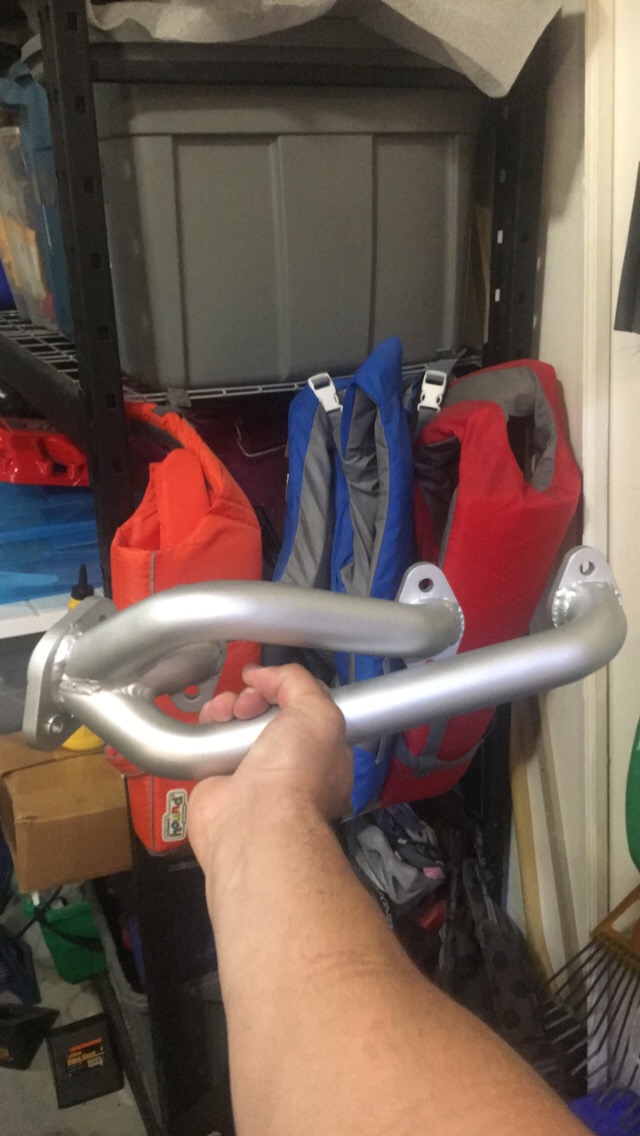

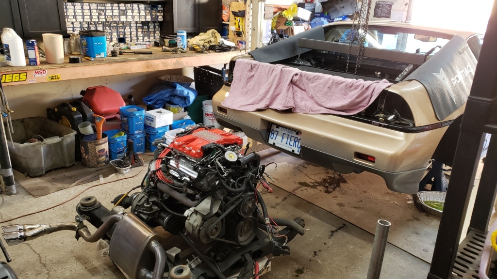

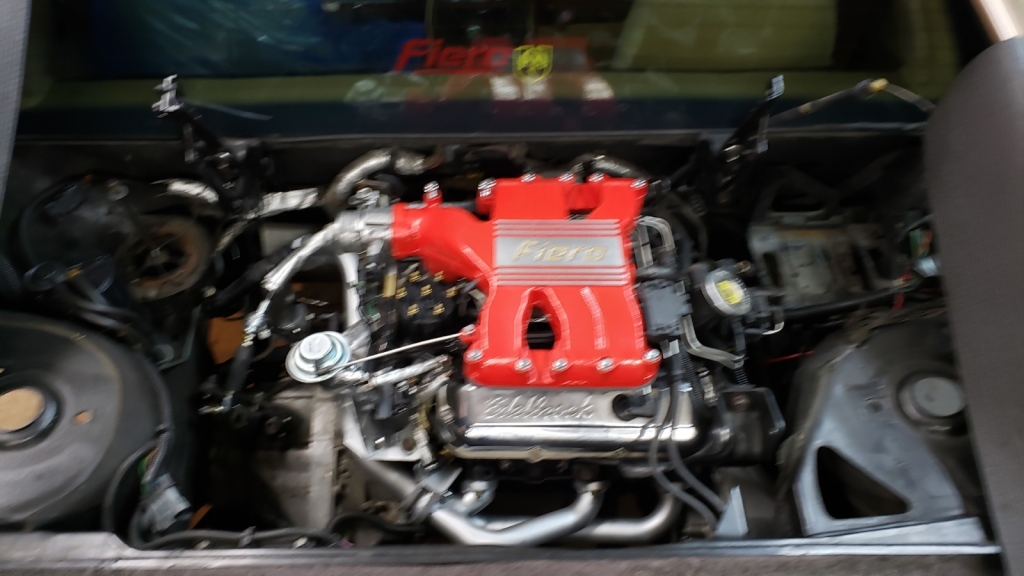

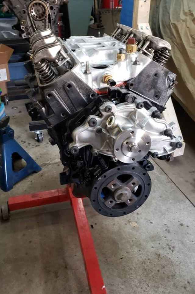

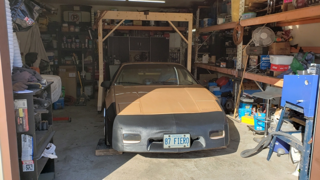

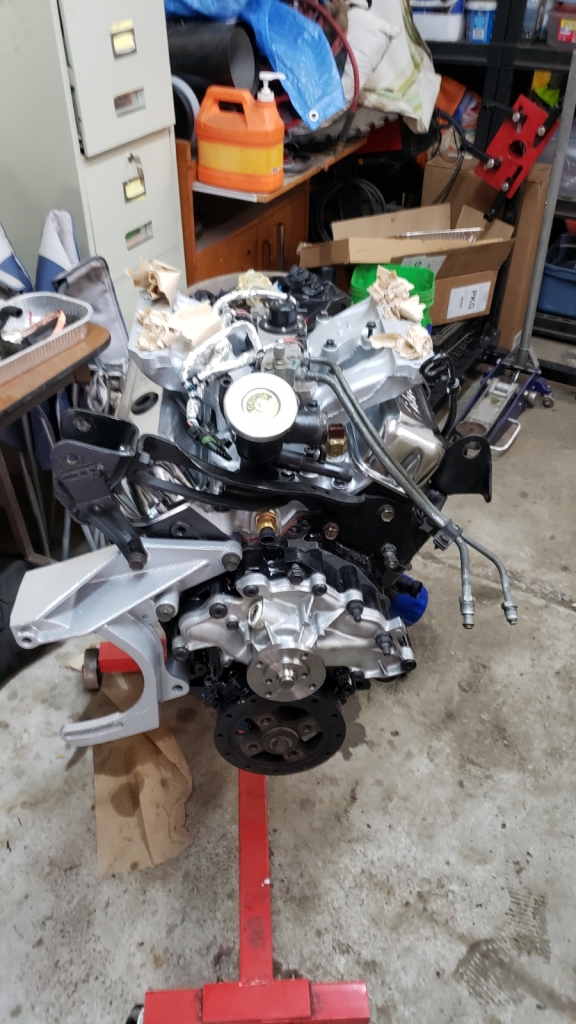

[img]http://images.fieroforum.com/userimages/jjd2296/E88 8AD3D-5B9D-4272-89C7-976AE3F7A39F.jpeg[/img][img]http:// images.fieroforum.com/userimages/jjd2296/9FC26AF3-E9C8-40FD-AE70-D44541395D33.jpeg[/img][img]http://images.fieroforum.com/userimages/jjd2296/E0F36137-820E-4 C85-8B60-3BB86BFE4ABD.jpeg[/img][img]http://images.fiero forum.com/userimages/jjd2296/AEC0C4DB-1DBC-4C26-B9BB-BDD11378F4B0.jpeg[/img][img]http://images.fieroforum.com/userimages/jjd2296/C278B5AB-592E-47ED-AB1F-0F6 82278C5CD.jpeg[/img] Just about finished my 3.4 pushrod build (thanks to local Ontario Fiero club members!).
Here’s the details:
3.4 rebuilt block
Ported heads
Sprint headers
Ported lower middle and upper intake
Bored out upper intake bracket and throttle body 57 mm
17lb injectors
RD power pulley kit
88 alternator
FS ss exhaust and high flow cat
260H cam

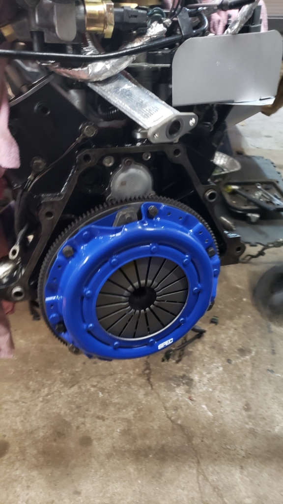

And a spec 1 clutch

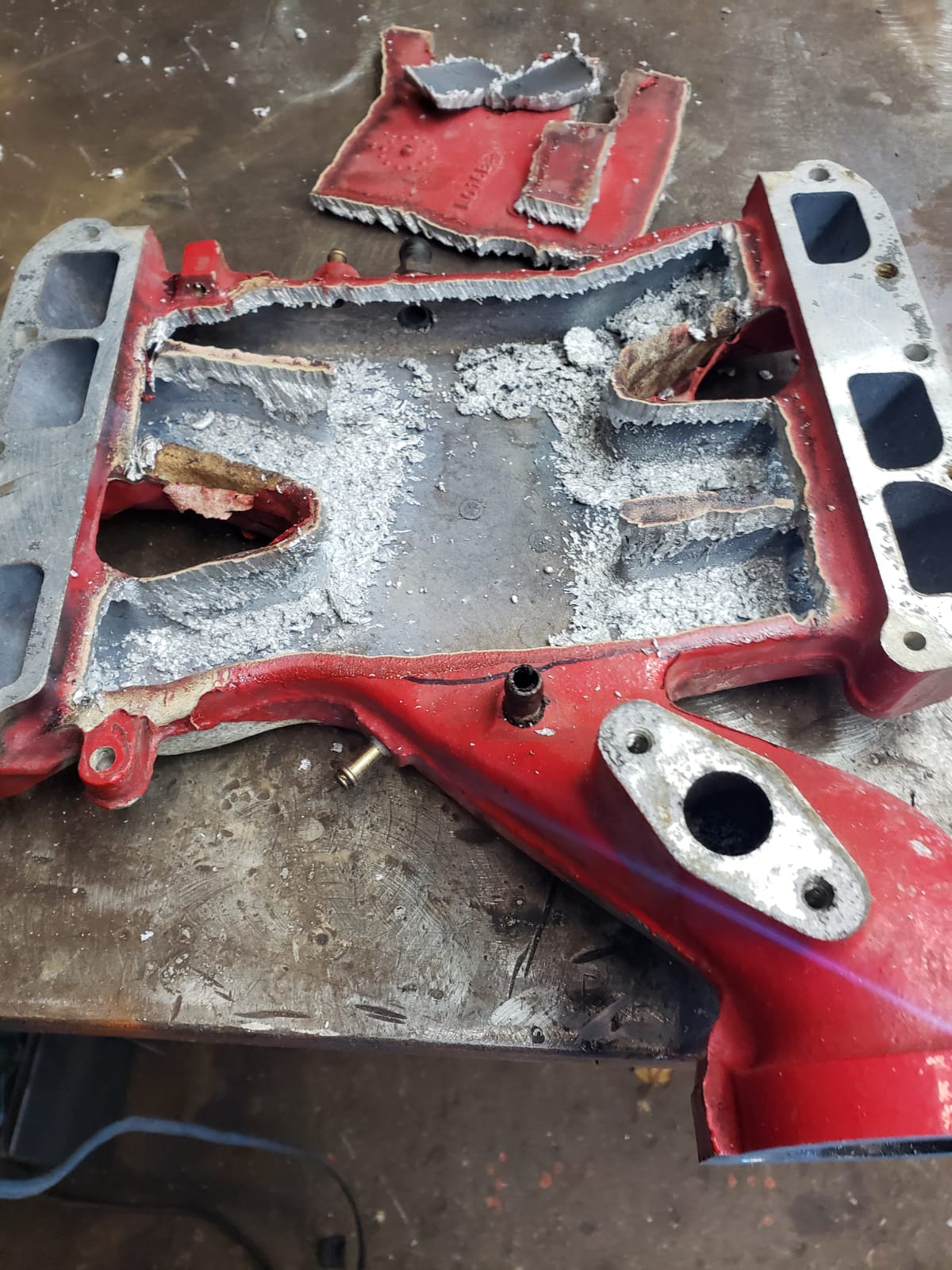

lou_dias DEC 02, 10:06 AM

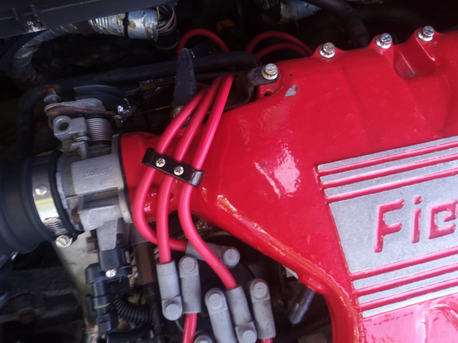

Also, in the bottom part of the middle intake manifold...
I would cross-drill some holes in the tube walls right above where it meets the LIM to increase your top end. I went a little radical with my experiment here and lost a little mid range:
