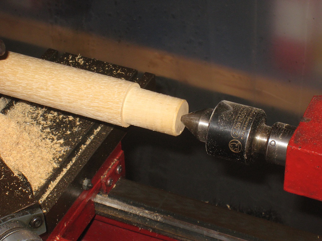

| quote | Originally posted by KissMySSFiero: Is it safe to assume a metal lathe can cut wood or plastic?
Plastic yes, I've done PVC, acetal, for sure some PE/PP on a metal lathe.
I made a wood paper-towel holder using a metal lathe, and the initial result wasn't so good. There was a lot of splintering. Probably some of that was due to not knowing how to cut tools for wood. I also think that typical wood-turning RPMs are higher than metal-turning RPMs. I ended up having to do a lot of sanding to get the paper towel holder OK.
