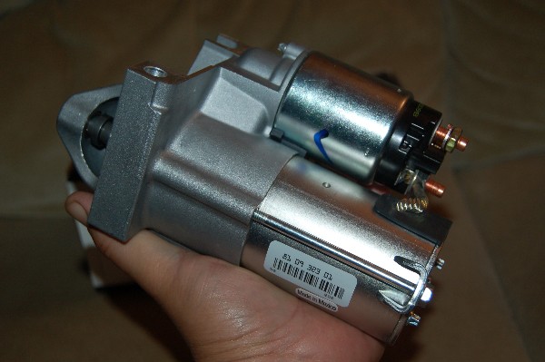

One of the very few *old* parts that I re-used during the 3.4L engine rebuild was the old original 2.8 starter. We took it to the parts store and tested it and it checked out fine, but I guess it finally has out lived it's time after 23 years of faithful service. The blasted thing has stuck engaged to the flywheel *running* one one occasion, and has disengaged, but kept running on another occasion. The solenoid is my first suspicion, but rather than rebuild that huge old beast, I've opted for THIS:
It's a new gear reduction type starter for a 98' Grand Prix 3.8L
I checked the OEM style starter against this one at the parts store counter and the mounting, nose length and pinion gear all look to be the same. Another thread here on PFF listed all the vehicles that this type of starter is used in and suggested it was a "bolt on" replacement for the OEM 2.8L starter which I used on my 3.4, so I figured I'd give it a try...

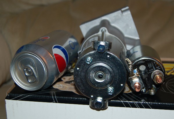

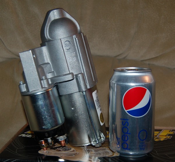

These pics give a better idea of how small this thing is:
If time allows, I'll be installing it tomorrow or Friday and hopefully it will fit and work properly. One thing's for certain...I won't have any trouble lifting it into place to bolt it in!
