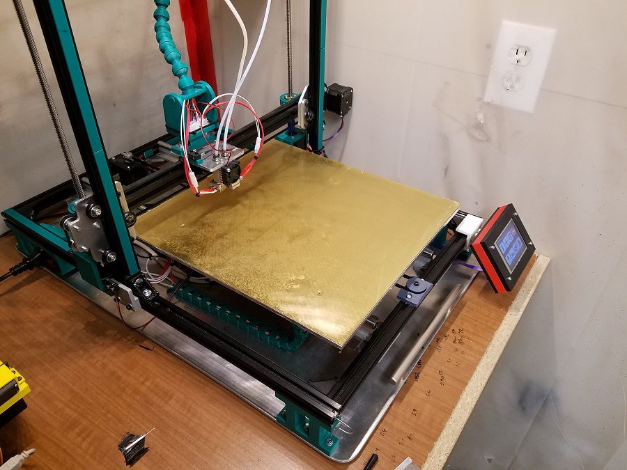

what printer are you using or filiment type?

I'm using a FLsun i3 plus I purchased as a kit and have modified with a 110vac heated bed and a PEI sheet to be able to print ABS without it warping. I use ABS filament for all the car stuff I make because it will stand up to the heat a car interior can see on a sunny day.

Speaking from my own experience... ABS is good but not completely impervious to car-heat shrinking. You'll get about 2% shrinkage over time.
