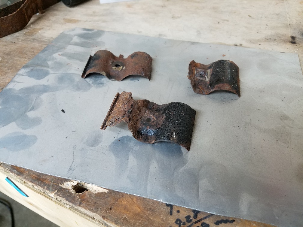

I recently had to drop the fuel tank on my wife's 88 coupe. The clips that hold the A/C and heater lines in place were badly rusted and needed to be replaced, the only problem is nobody makes them.

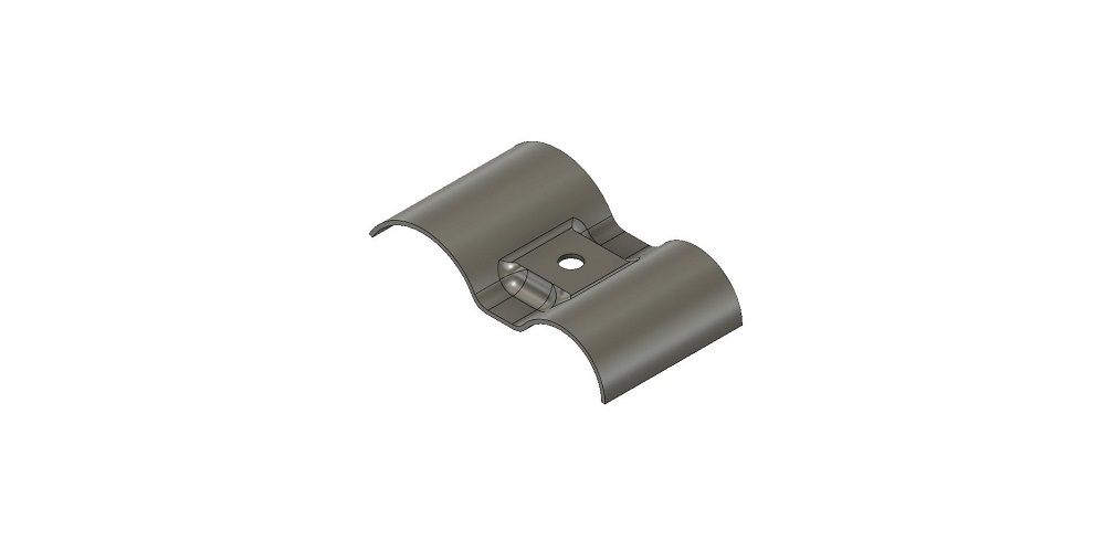

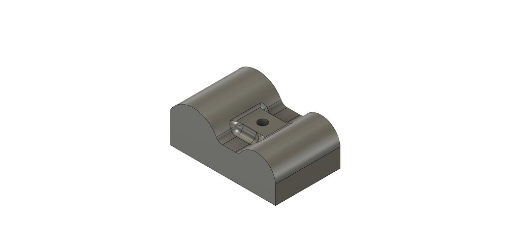

What to do? 3D printing to the rescue. I took some measurements of the original clip and modeled it in Fusion 360.

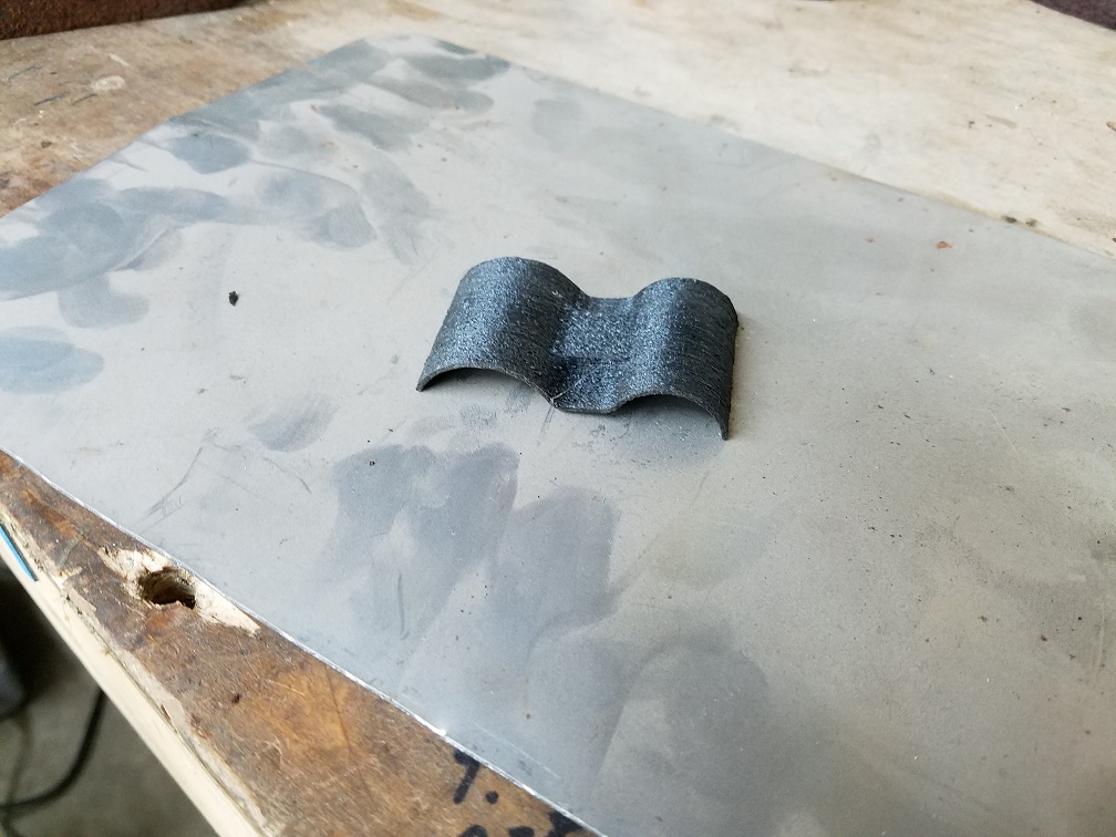

I printed the model to check that it was going to fit.

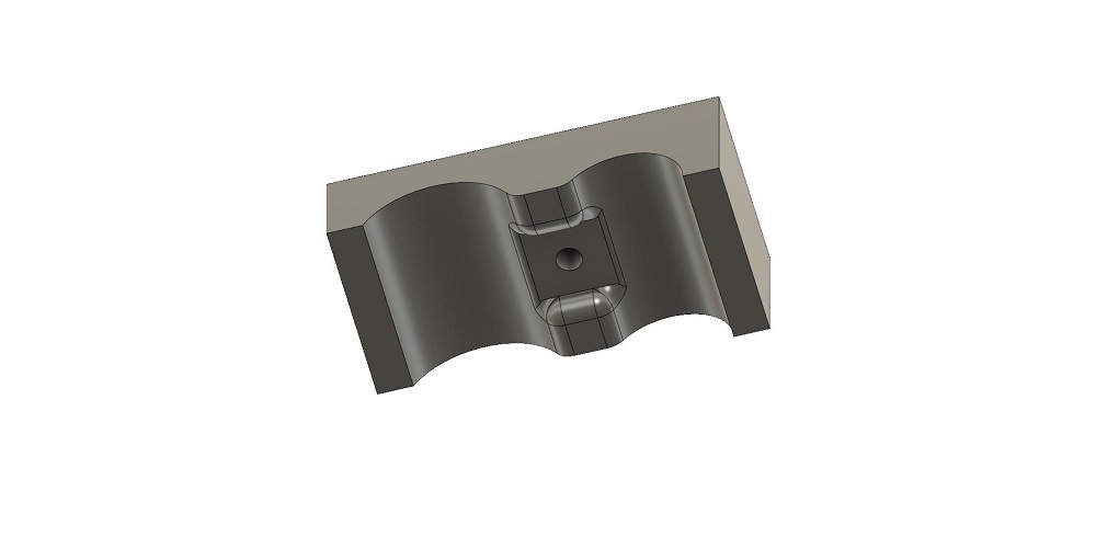

There is an operation in Fusion 360 called "extrude to object", I used that feature to easily extrude a flat part into the positive and negative sides of the model to create a die set to make some new clips. By doing it this way, there is a gap designed into the dies equal to the thickness of the sheet metal blank.

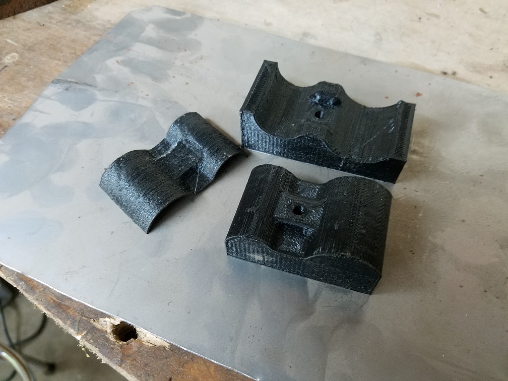

I printed the die set in ABS plastic with a 70% infill and a 1mm top and bottom thickness.

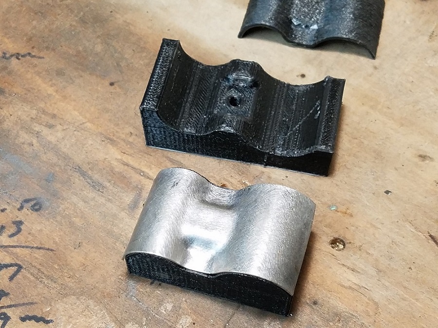

I cut a blank from 22 gauge galvanized sheet metal, coated it in spray wax, and loaded it in the press. I really wasn't sure this was going to work, I thought maybe it would bend the metal a little bit and then the plastic would break. But to my surprise it worked great! The metal blank easily formed into shape without any damage to the plastic die.

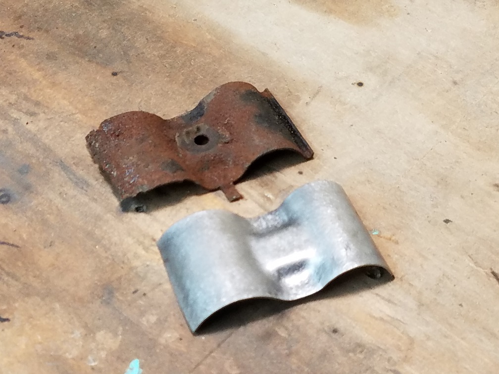

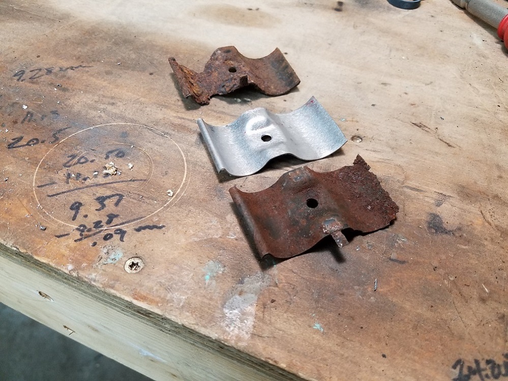

So here is a pic of the new unfinished part next to the original piece. The locating tang isn't there but I think it should work just fine without it.

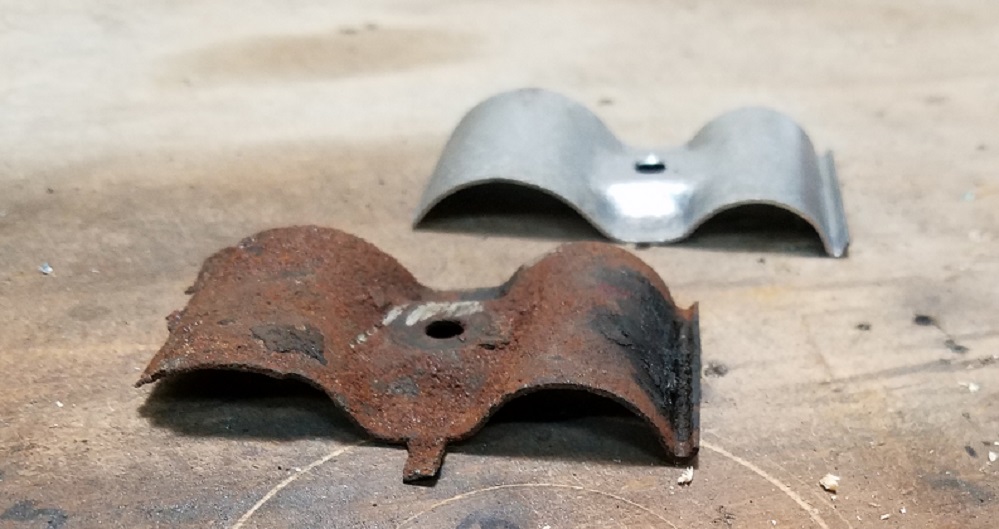

To finish the part I bent up the lip in my brake and drilled a hole for the screw. Here are a couple pics of the finished part next to the old ones.
