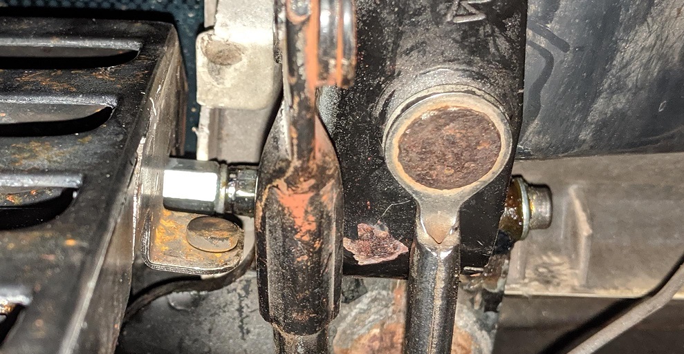

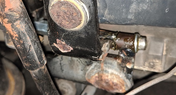

Day 3 I go to title and plate the car. The PO signed the title but dated it for 2015! The BMV is trying to charge me 4 years of registration fees, 4 $15 late fees, 1 $30 late title fee. I ask them to hold on and I contact PO. He apologizes and quickly fills out an affidavit and faxes it to the BMV ( Indiana is very German it is a Bureau here not Department) so I get that cleared. I got to Autozone to grab a starter. They take soo long I finally get out of there and get home. When I pull up the neighbor is admiring her so Im like yeah come on over and take a look. I pop the deck lid to put the starter in the trunk for storage until this weekend when I can get it installed. I lift the lid and POP! the left hinge sears the pin. My neighbor being gracious helps me to take the deck off since I can not close it with the hinge sprung. It starts raining on us right then. We get the lid off and covering the bay and trunk again by setting it over, I throw a tarp over bay and trunk first. We talk for a bit and it stops raining. I try to punch the broken pin out, it will not budge, I try to drill it out and break 4 drill bits. I call it a day.
Today I start looking up hinges and what to do to fix. They all sat to replace, replacements are not easy to come by, I develop a new plan. I get on McMaster Carr, I order me a piece of .500 OD x .260 ID tube, a bag of 3" 1/4-20 18-8 stainless steel socket head cap screws to use as a pin, and a 1/4-20 18-8 SS coupler to use a the vent rest. Friday I am going to cut off the pin and barrels cut new pieces of tube and weld them in place. (Tomorrow I have a birthday party to attend.) Saturday I hope to get all my parts installed so I can actually drive her.

These are pictures of my hinge pin solution. it is a 1/4-20 stainless steel socket head cap screw with a Nylock nut, a locking washer backed to a coupling nut to act as the vent support. I cut off the corroded solid barrel and pin then welded on a new barrel made from a piece of .500" OD steel tube with a .260" ID. as you can see in the picture it is loaded with grease on the inside... I will mask off and paint it all. Also you can see that the limit cable is gone on this side and looks to have been this way for years.
