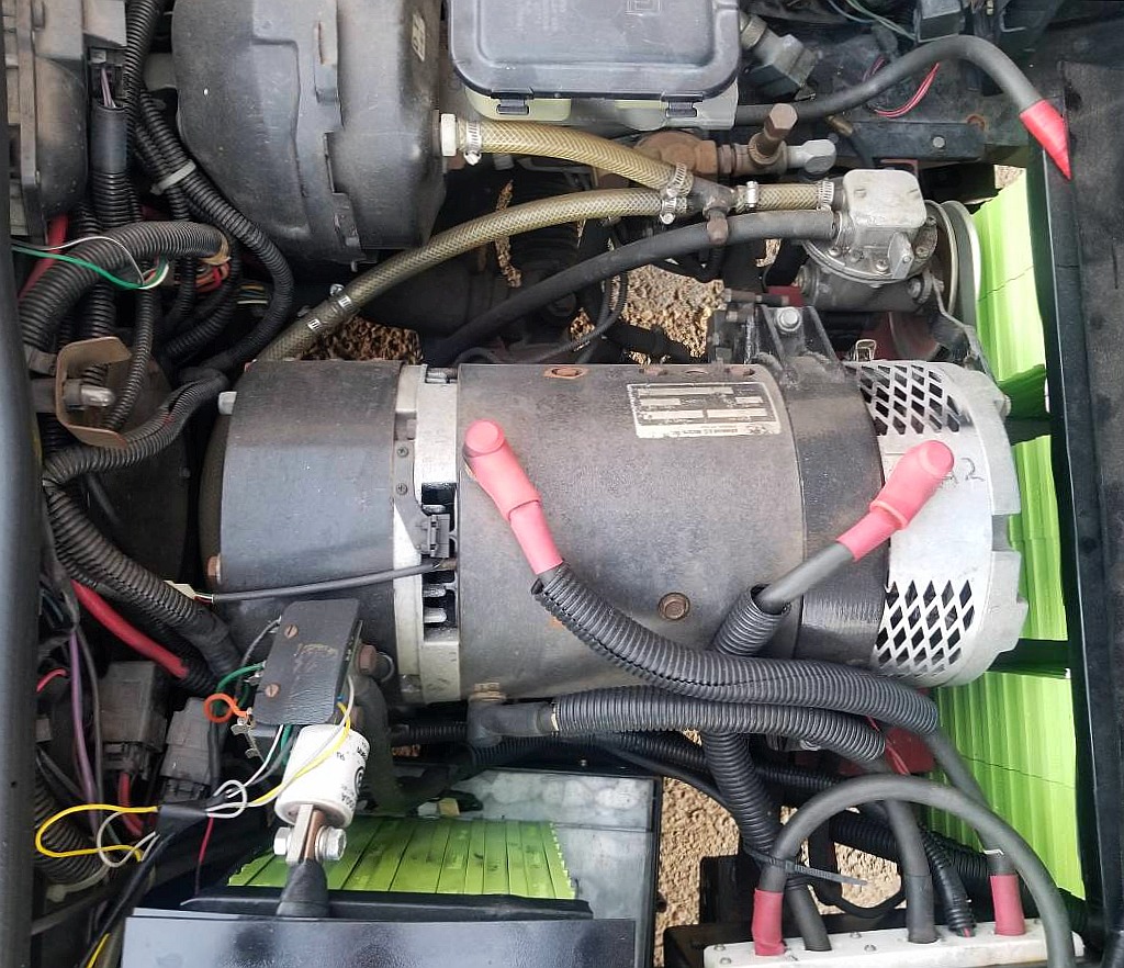

With the electric motor located up front, I'd be curious what drive train was used to get the power to the rear wheels. I would've thought that putting the electric motor in the back might've been simpler.

I'd rather have all those batteries behind me than in front. The thing must understeer something fierce, though.

I am pretty sure they installed a solid rear axle and just ran a driveshaft to the motor shaft. No precision adapter plate needed. So it might have been easier for them to do it this way vs. designing and machining an adapter plate.

Looks like they installed a belt driven vacuum pump for the brake booster and the other line off the Y fitting might go to cruise control or does ac/ heater coil need a vacuum source? Assuming the black line is the vacuum outlet side. [This message has been edited by BadNewsBrendan (edited 04-30-2019).]
