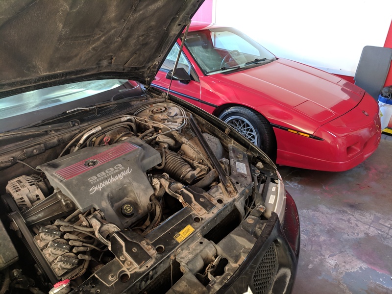

The donor

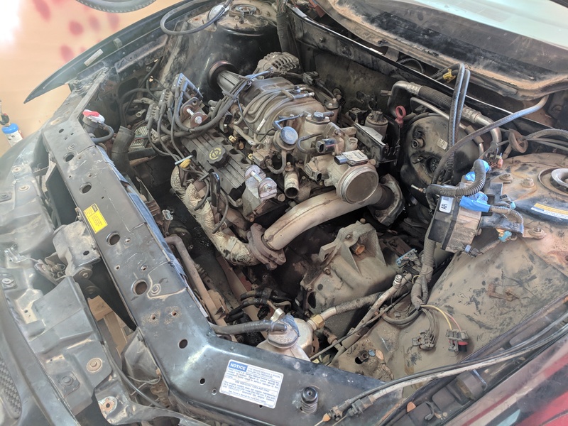

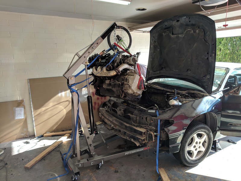

Took about a day to get the engine/trans ready to pull
And pulled it out the top. I got the hoist super-cheap from Harbor Freight, open box. Just needed a few nuts and bolts from the hardware store

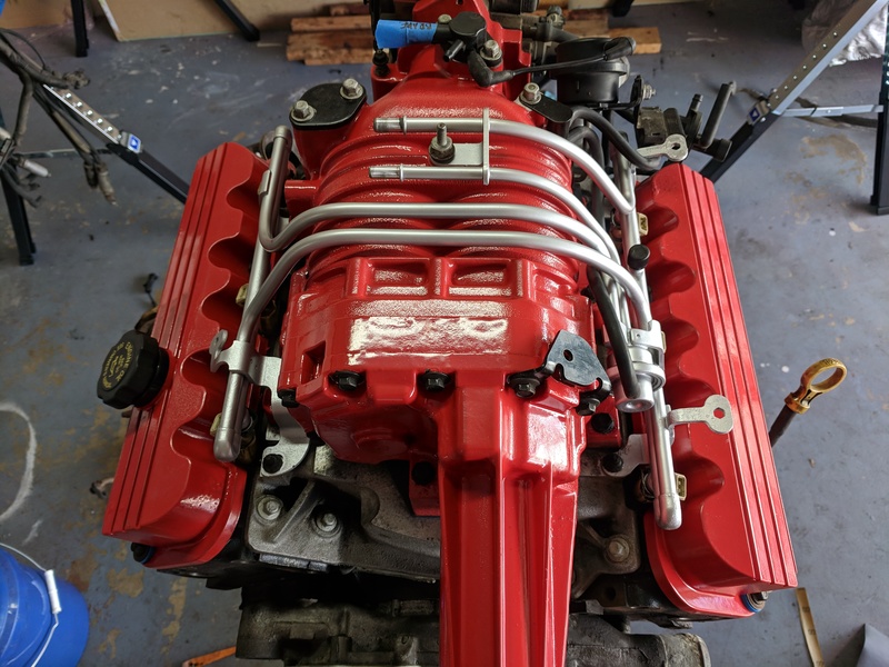

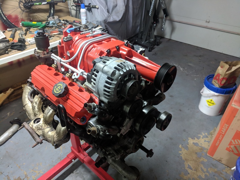

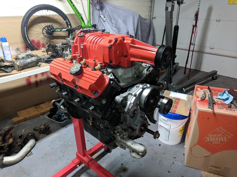

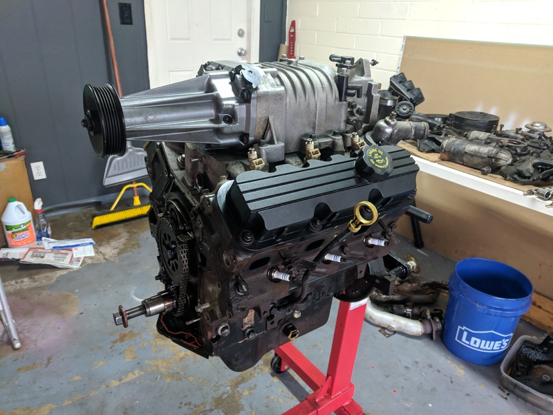

All cleaned up and painted. I'm just replacing some seals/gaskets, nothing else.
Painted fuel rail
I'll probably keep the alternator and heater core lines in the stock location, so I don't have to mess with custom brackets and pulleys.

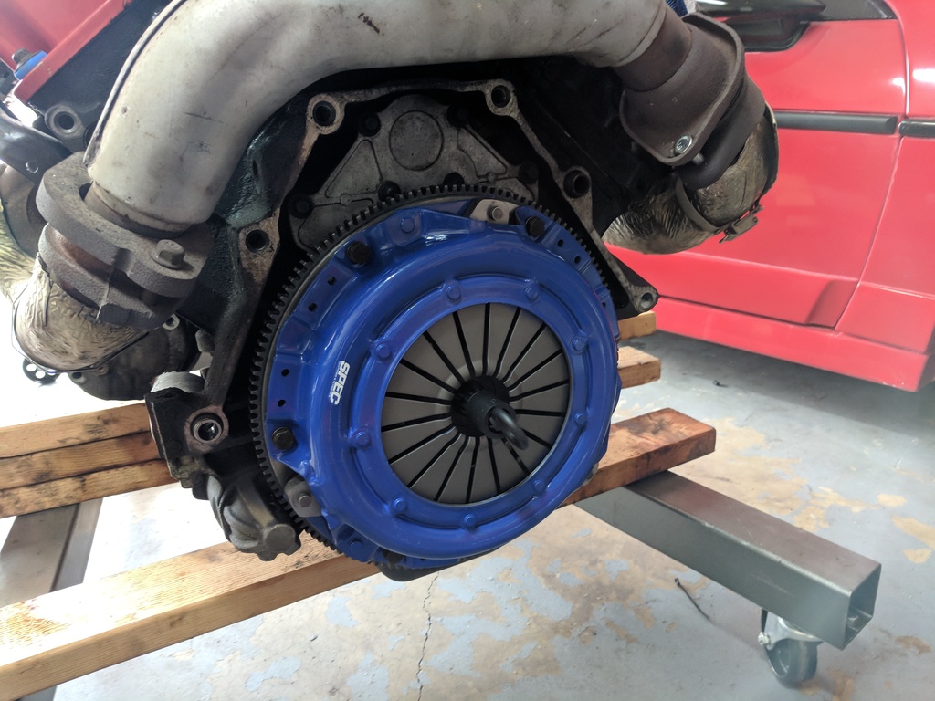

Made quite a bit of progress. Huge shout out to FieroRog for his mounts/ flywheel and Danny McIlmoyle for his swap harness. Both had excellent fit and finish.
I went with the spec 3 clutch. It was quite a bit cheaper than the 3+ but I read mixed reviews about chatter.

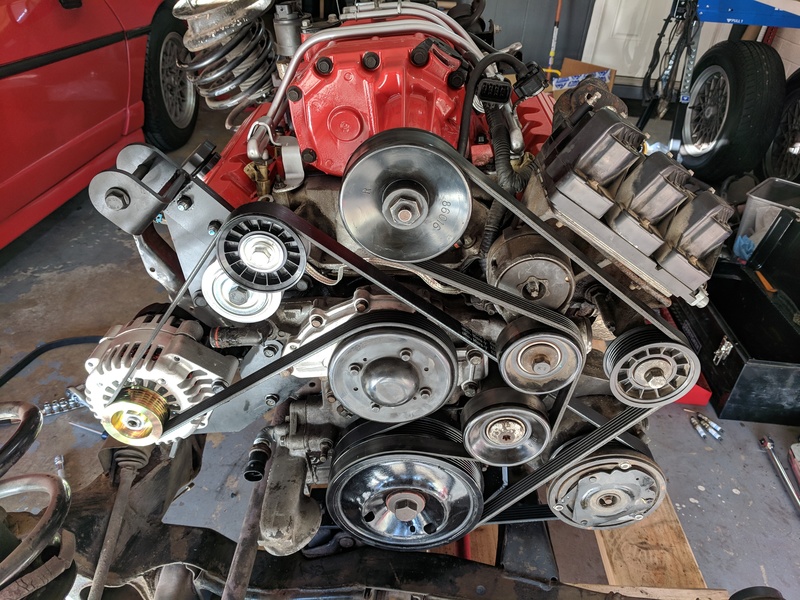

Mounted on the cradle with FieroRog's engine mount and low alt mount. The low alt mount had very little clearance with the oil pressure sensor so I got a 90 degree fitting from lowe's to point it towards the front of the engine. I also decided to reuse the plastic 90 heater hose fittings in the timing cover and LIM. Not sure why I haven't seen more people do this, maybe then possibly popping out when the system is pressurized? I'll probably fab up something to keep them in place.
The two biggest things holding me back are the shift cables and exhaust. I've seen threads on people fabricating adapters to move the shift cables from interfering with the crossover but this will be difficult as I don't have a welder. Same goes for the exhaust. I'm also trying to figure out how to mount the coil pack, since I want to keep the battery in it's original location. The connector doesn't have a very long lead and doesn't leave many options. Has anyone tried keeping the battery in place and mount the coil pack without extending the connector for it?
Spoon MAR 15, 09:27 PM
3800SC in progress and I'm using the 4 speed Muncie. Those shift cables interfere with the throttle body and the exhaust crossover. I used Rodney Dickman's Repair Kit that holds the cables connectors in place. The ears are known to break.You cutoff the cable bracket ears and bolt the new one in its place. Don't over grind or you'll end up like me and have to start over with another mounting bracket.
I cheated and offset the new bracket to give me clearance from the throttle body and hose clamp on the intake duct. I'm using WCF headers and the 1 cable barley clears the crossover. I'll be adding heat shielding . I'll post my pics later when I find them. I have pics of other creative attempts to solve this situation and will post them too.
