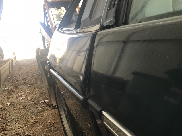

I took off my rear clip a few months ago to do some rust work. Now that I have it bolted back in, it doesn't sit right. The sides kind of stick out, and it's just not aligned. How do I get it back in place?

Pictures would help us help you......

 Mainly here.
FEB 12, 11:53 AM
The lower panel fits inside the groove at the leading edge of the top piece.
When assembling the rear portion, set the upper part on the spaceframe, then put the rear quarter panels in place before installing any fasteners to either part.
