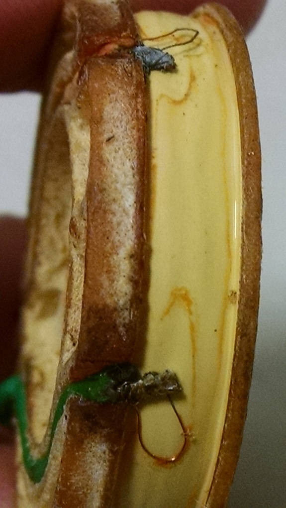

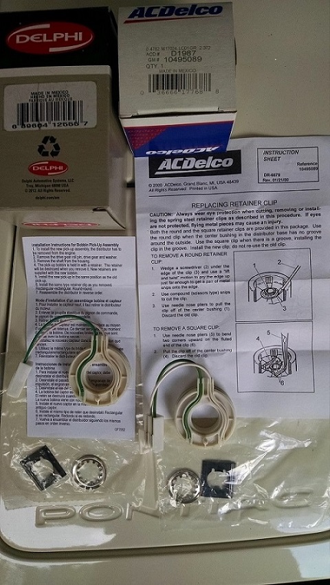

I feel your pain. If the fuel delivery system is ok, try testing the pick-up coil. You might also try a known good ICM.
This happened for me a few times over a couple of years before the culprit was definitively identified.
The cause: intermittent bad solder joints on the pick-up coil.
I bought two brands to see if they looked like they could be from the same manufacturer; the plastic molded parts looked identical.
I also had a 2.5L quit twice in three years without any warning while driving. Had fuel & spark. Tried a spare ECM each time & it started right up.
