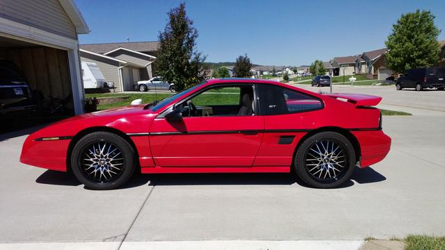

Well, I felt the clutch starting to slip, then my coolant crossover tube sprung a leak... So, I might as well tear it apart and clean, replace, restore whatever I can.
I was just going to drop the engine with the cradle like everyone else, which makes sense, but I decided I had the time and like to try things of difficulty just for fun! I pulled the engine through the top with the car in the air; it was fun, I learned a lot and wont do it that way again...

It looks like you posted pics, but they don't seem to be accessible...
When I posted this reply, the pics showed up. Hmmm....
