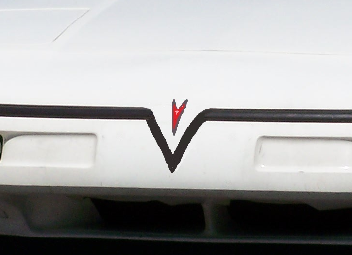

I have a 1985 SE V6 that I have modified; 86-88 GT rear quarters, but without the ground effects, stock SE rear bumper and 87-88 base car nose.......One of the mods I wanted to do...But probably will not, was to take the rub strip and curve it down in the middle of the front facia, coming to a point, with a G6 trunk Arrowhead emblem in the "V"....I have a photo I modified, but cannot post images here...I could email it to you.....

cvxjet NOV 08, 10:13 PM
Hey Harold...You can post my pics here if you wish......
