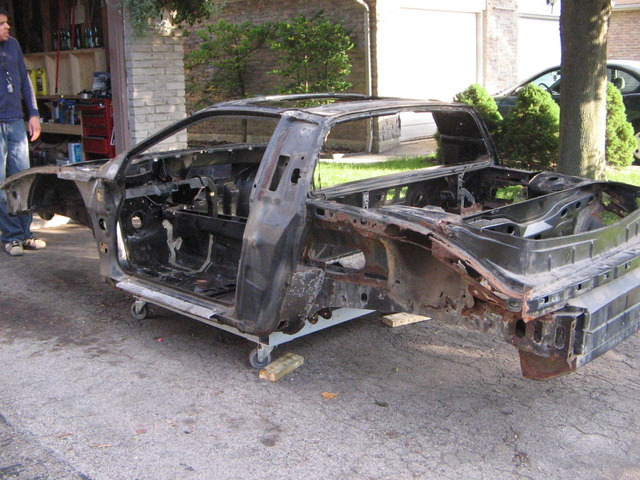

How were you able to attach the frame to the dolly? And how to keep it from shifting on a trailer in corners or if any hard emergency braking takes place?
Gall757
OCT 21, 12:59 PM
quote | Originally posted by FieroGT42:
How were you able to attach the frame to the dolly? And how to keep it from shifting on a trailer in corners or if any hard emergency braking takes place? |
All good questions. I saved that picture from a very old thread....I was not there to see what happened....

Once it's on the trailer, you could jack it up from the dolly, put blocks underneath & strap it down tight onto the blocks.
