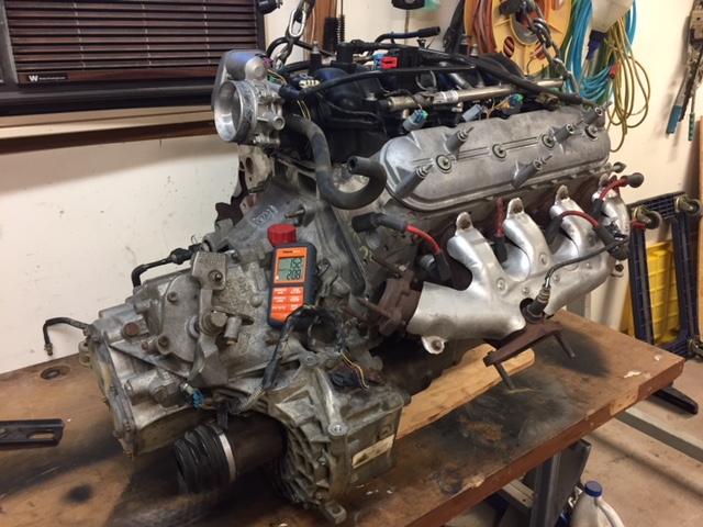

Plenty of room...
IMG_20180530_073033069 by Joseph Martin, on Flickr Jeez, I need to do some housekeeping...  Joe[This message has been edited by motoracer838 (edited 05-30-2018).]

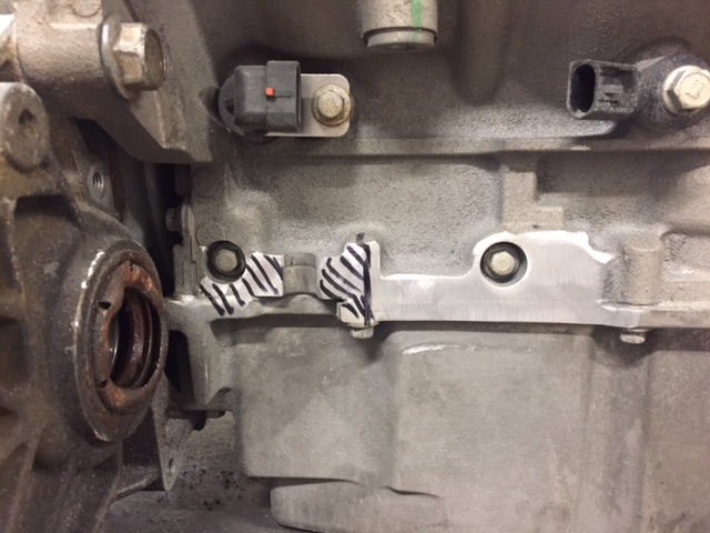

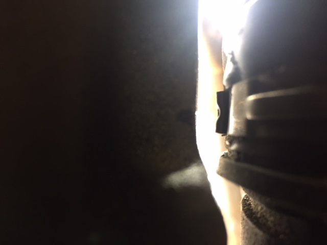

KissMySSFiero
JUN 01, 08:29 PM
| quote | Originally posted by motoracer838:
An intermediate shaft is the only way to do this, Less than zero room for a tripot at the trans, the LS engine is even wider than the Northstar. |
How much room would be needed? I've clearance mine and I'm getting about 0.160" by grinding back to where the oil pan gasket was recessed. I'm sure I took some out of the gasket, but minimal. I won't do more until I pull the pan to see how much meet is there. It looks like a lot was removed, but I removed mostly the rough casting. The 0.160" is at the cv boot band. I also tapped it a few times at the crimp so I would be closer to flush. Depending on how thick the oil pan flange is, I think I could get 1/4" of clearance pretty safely. But, is that enough?

motoracer838
JUN 01, 08:53 PM
| quote | Originally posted by KissMySSFiero:
I honestly didn't think a cv would fit in there, looks like you have enough clearance. Given the amount of hp and torque these engines can make without trying, I'm not sure I'd want to run a long/short axle combo. I think there is the potential for some pretty hairy torque steer... I just excorsized some nasty handling traits from one car, don't want to build some into another...
