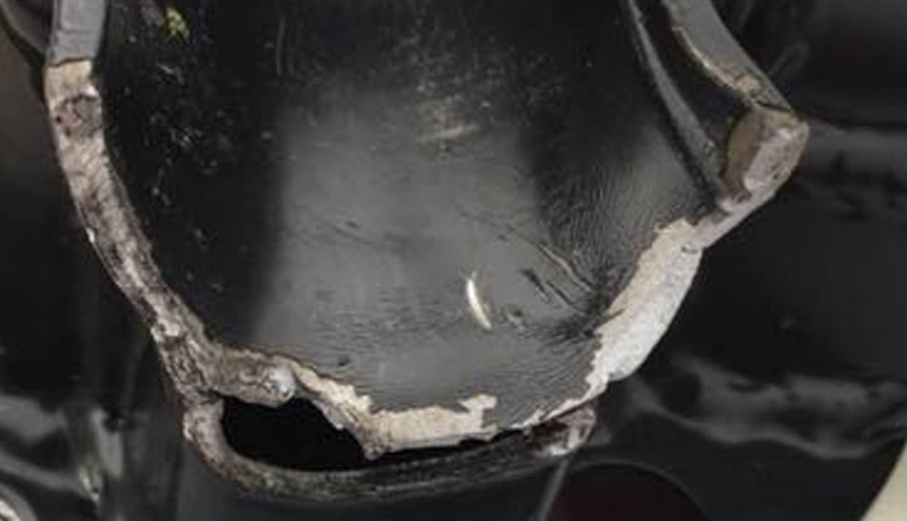

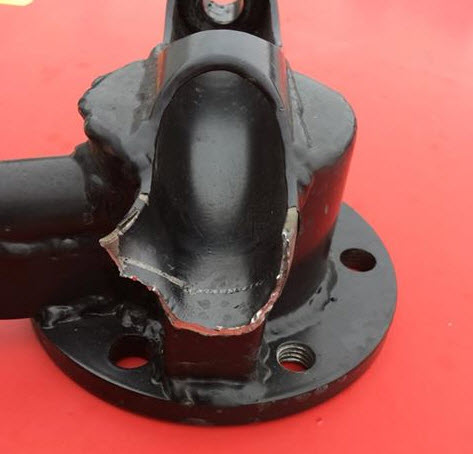

I’m not one for business bashing, but if this message prevents an accident or even prevents someone’s death, then it’s worth posting it. This is a message to anyone using the Arraut Motorsports Slalom kit or any of the Arraut drop spindles. I ordered a slalom kit for our 24 Hours of Lemons F40 replica build. During our 1st race last weekend in NOLA we had both the DS & PS side steering knuckles break during the race. BOTH knuckles BROKE during the race. These are supposedly race proven parts that broke during the very 1st race!!! (See attached pics) WARNING: If you are running the Arraut Motorsport Slalom kit or their drop spindles on your Fiero,... PLEASE PLEASE PLEASE check your spindles/knuckles ASAP. This is a serious danger to anyone using these parts on their Fiero. PLEASE help spread the word. Thank You!

Wow, I've never seen their products installed but man, how much thinner could they have gone with the metal? That is a horribly manufactured part. Hopefully no one was hurt.

Wow! That is a serious problem! From the video you posted, it even appeared that you were simply driving pretty much in a straight line when it failed.
It is hard to tell by looking at the photos, but the metal almost looks like a porous cast type metal, aka pot metal.
The bottom line is that there is something seriously wrong if the failed on the first race, on such a smooth and well maintained track.
I was thinking the same thing. If that is cast, there is no way those will hold up safely under any driving conditions.

Not cast, they are.fabbed from tubing and plate steel.
I've installed a couple of sets, was not impressed by fitment or quality.

After having a set of those spindles in my hands (I installed a set for a local club member), I'm not surprised that they broke. The spindle is a critical part, so IMO it needs to be over-engineered. But the Arraut spindles appear to be made "just good enough".

It looks like it had been cracked for a while. A clean break will be a light grey, but if there was a hairline crack for a while, that material starts to rust and discolor. From the picture, there are several areas that look discolored and would indicate a pre-existing crack prior to the final failure event.

Well the design itself leaves all the pressure literally on a piece of pipe that is cut in half. Thin metal or not I bet I could put a pipe wrench on there and twist those ends off.
Those need to beefed up considerably . They look like cheap lawn mower parts.
