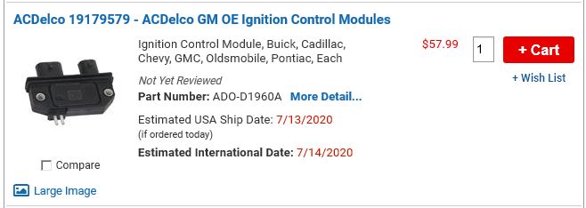

Also, I noticed on eBay, another ACDelco part, D1960A, match up for Fiero GT. Hmm
But when I looked up D1960A on Amazon, it says it's not compatible. How strange!
When I used the part number # 10496269 for ICM from 22P book, it ties to D1960A.
Oh boy, sometime it gets confusing trying to find the right part. Ha

fierogt28 JAN 10, 01:54 AM
Ya, the D1960A is listed for the 86GT, but the 85GT is listed the same for the 87-88GT. (D1943A)
I have no idea why this is...

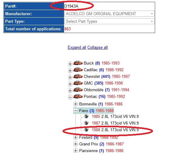

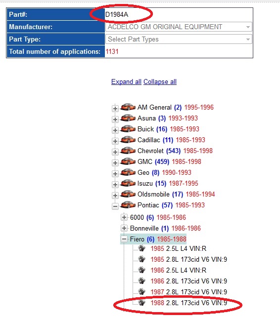

Fiero Vice JAN 14, 02:08 AM
Guys, turns out both D1943A and D1984A are compatible for 88 GT.
Here's two pictures from ACDelco website for confirmation.

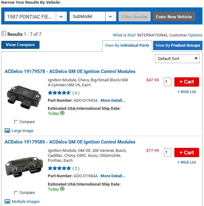

Lets muddy the water some more... LOL
Apparently all the same, except for economy, middle and "professional" grade.
[This message has been edited by fierosound (edited 06-10-2020).]
fierosound JUN 09, 07:34 PM
Then there's the "performance" modules.

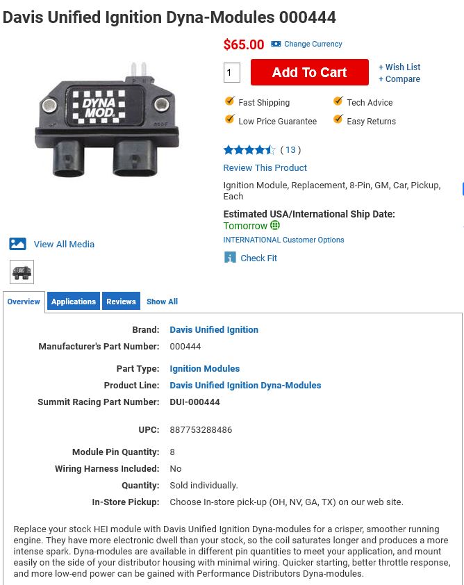

Davis usually has good products.
But this may just be a Delco module with his sticker on it.

cvxjet JUN 09, 09:18 PM
Has anyone tried the DUI module? As stated above, DUI usually has quality stuff....On their website they claim "Longer Dwell" and go on to state "Better idle, and low end performance....Anyone...?
