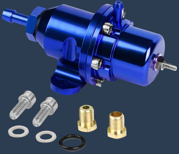

I had installed this one from Amazon.
It has a single input, single output, and the port for the vacuum line. There is NO hookup for a return line, so in my case that was perfect.
It shows 52 PSI on the gauge when the car is running, and I took that as factual. However when the mechanic was here, noticed it never fluctuated when blipping the throttle He shut the car off, sucked on the vacuum line, and could taste fuel vapor. He explained that it had a bad diaphragm, and was probably not supplying enough fuel, as well as fuel possible traveling into the intake through the vacuum line.

Are you sure that that regulator wasn't meant to regulate pressure returning to the tank? In the questions section the seller says it is for a return system. If that's the case, then I bet that what the regulator is actually doing is regulating the pump outlet pressure to be some set amount above rail pressure. which happens to result in a nice constant rail pressure and a pump being overworked at 100+ psi. I think that it should have been set up like in the picture above, regulating the excess pressure to bleed off back into the tank.
