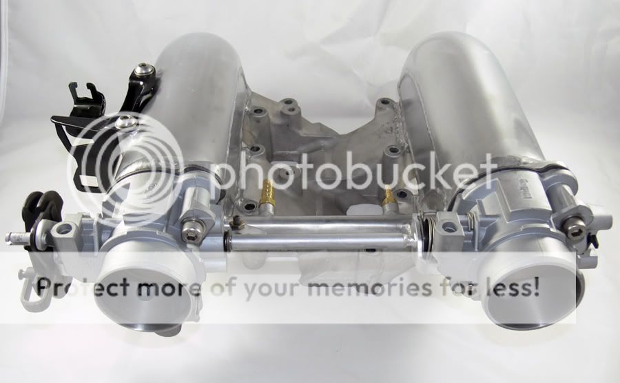

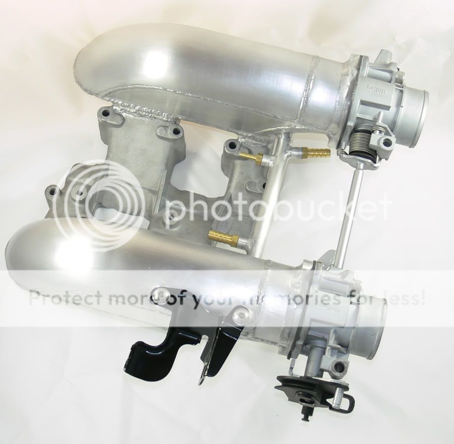

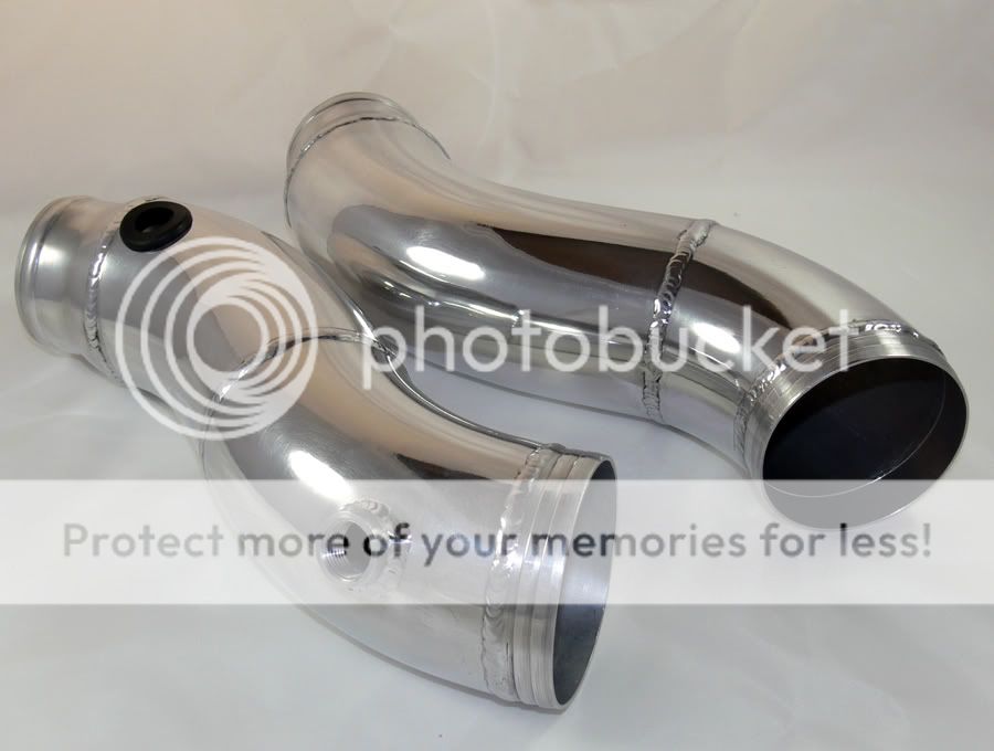

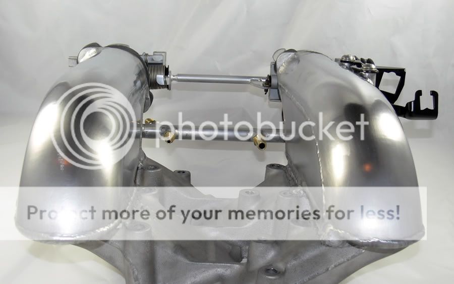

Here are some more examples of the fabrication process:

Hey Chris, the pictures you showed look great.
I definitely think there is a market for this. 2.8, 3.1, and 3.4 engine users could easily benefit from this. The look of them is very eye catching, and would stand out from the crowd. People like to do the DAWG modified plenum, and plenty of others for their cars. But this would be the #1 choice for users. I think you'd see a good increase in sales if the price was dropped a bit. Even $1,000 would be reasonable enough for the average Fiero owner to buy.
