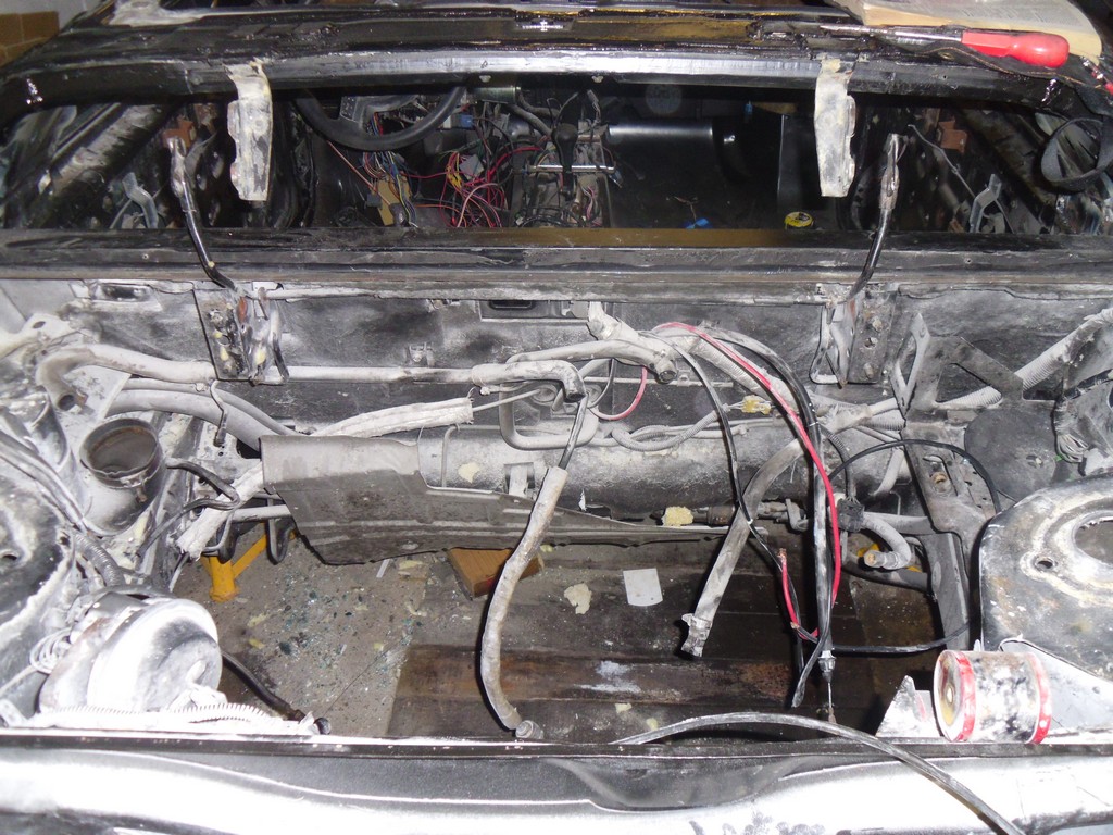

The car minus body panels ready to perform the chop

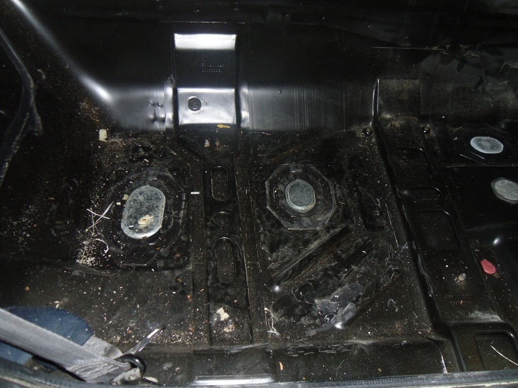

Nice rust free floor plan

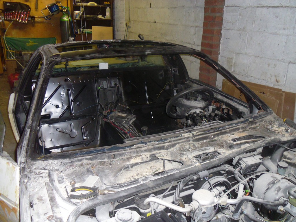

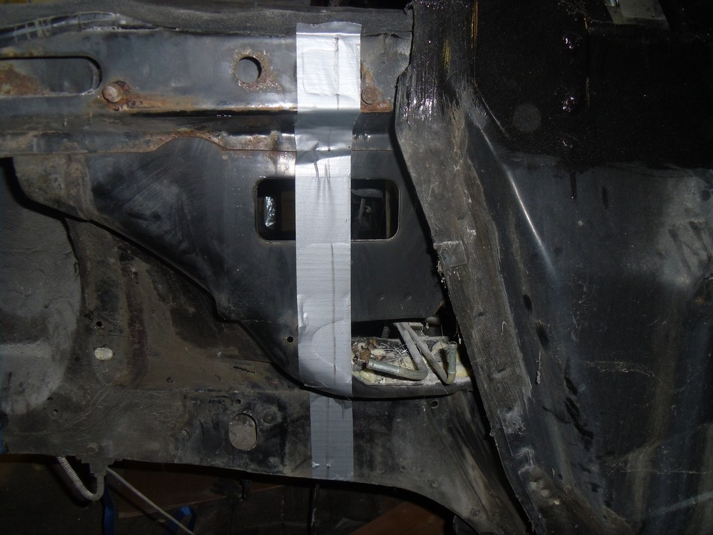

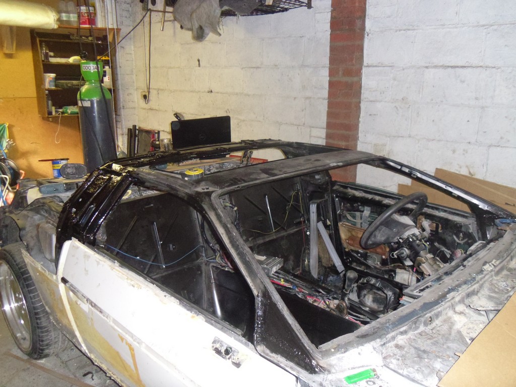

Got all the cuts done will start to get it aligned up and welded up over the weekend

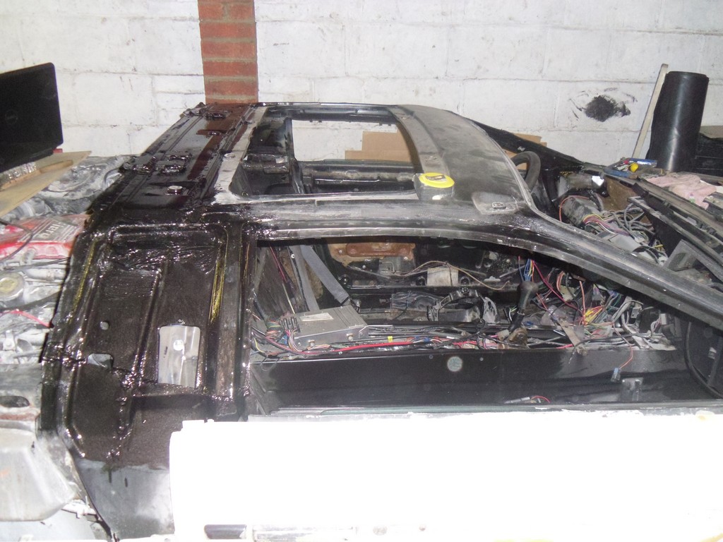

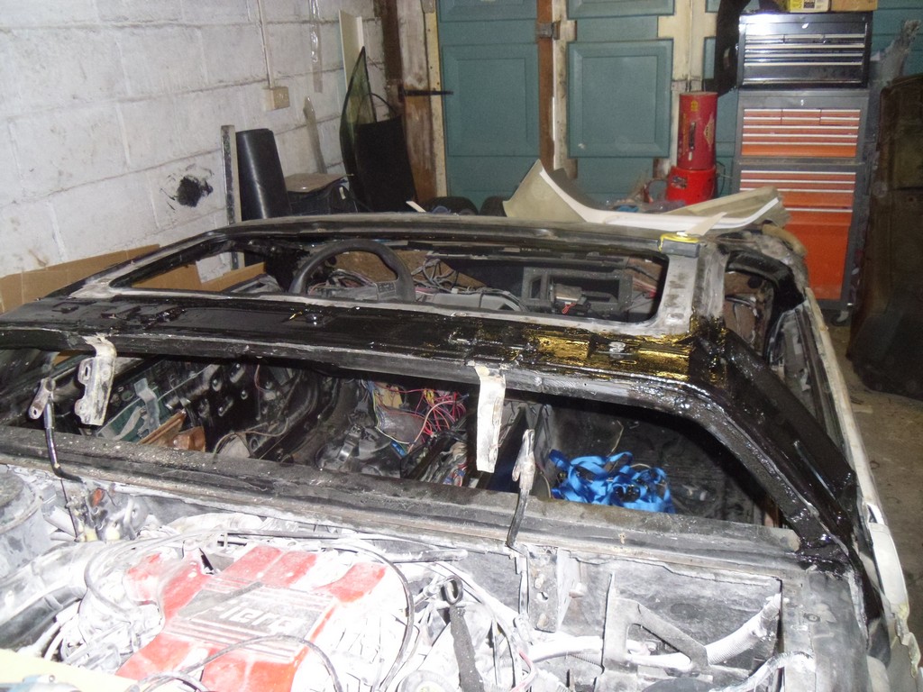

Got the last of the welding done at the weekend, now time to move onto the next stage of the build.

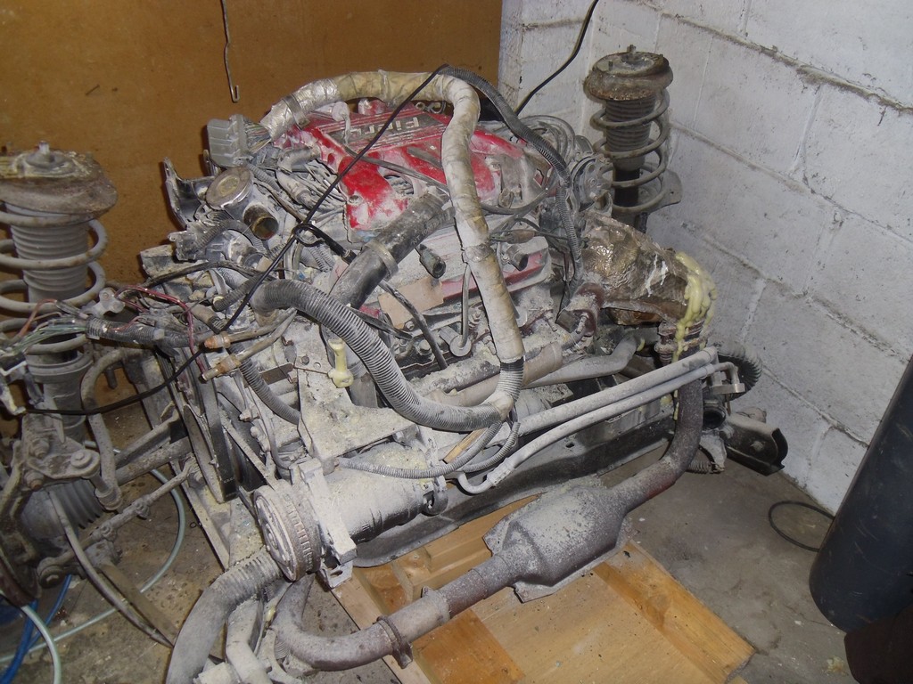

Some more progress pics managed to get the engine removed ready for the next stage also ordered a new steering rack to weigh up the possibilities of converting to a RHD.
Out with the old

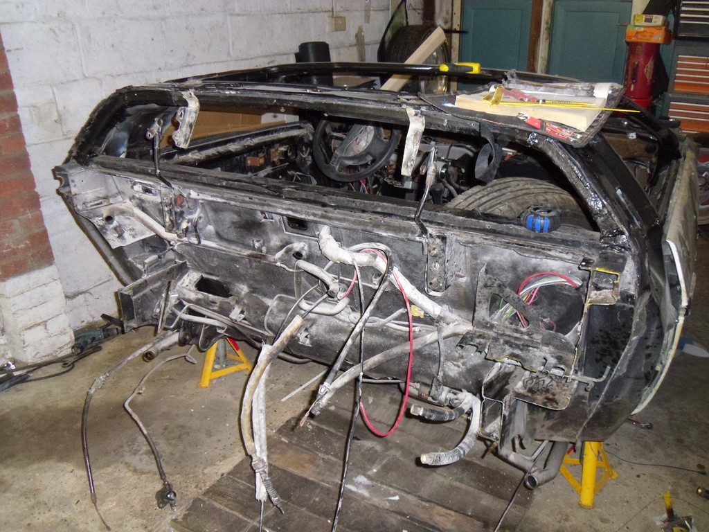

Quick shot of what is going to happen this evening more cutting.
The stretch is 13" and not for any kit that I am going to modify the existing body panels
My car fell in half

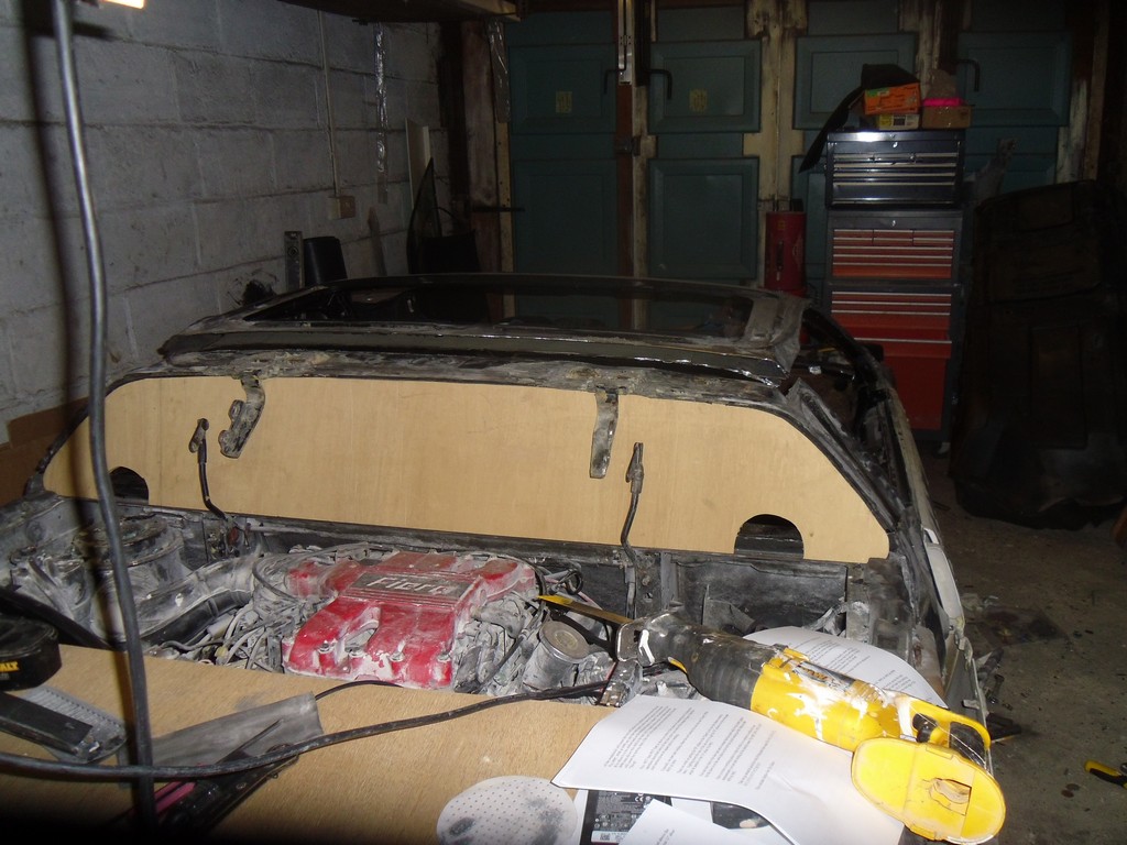

Finally got to do some work on the car tonight see if you can see whats different.

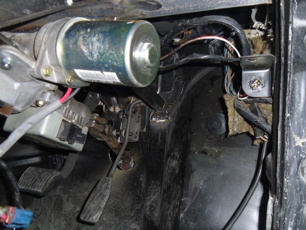

This pic shows the new pedal assembly need to tweak the angle of the pedals a little bit though, also the clearance for the colum uv joints and a bit of the bracing.

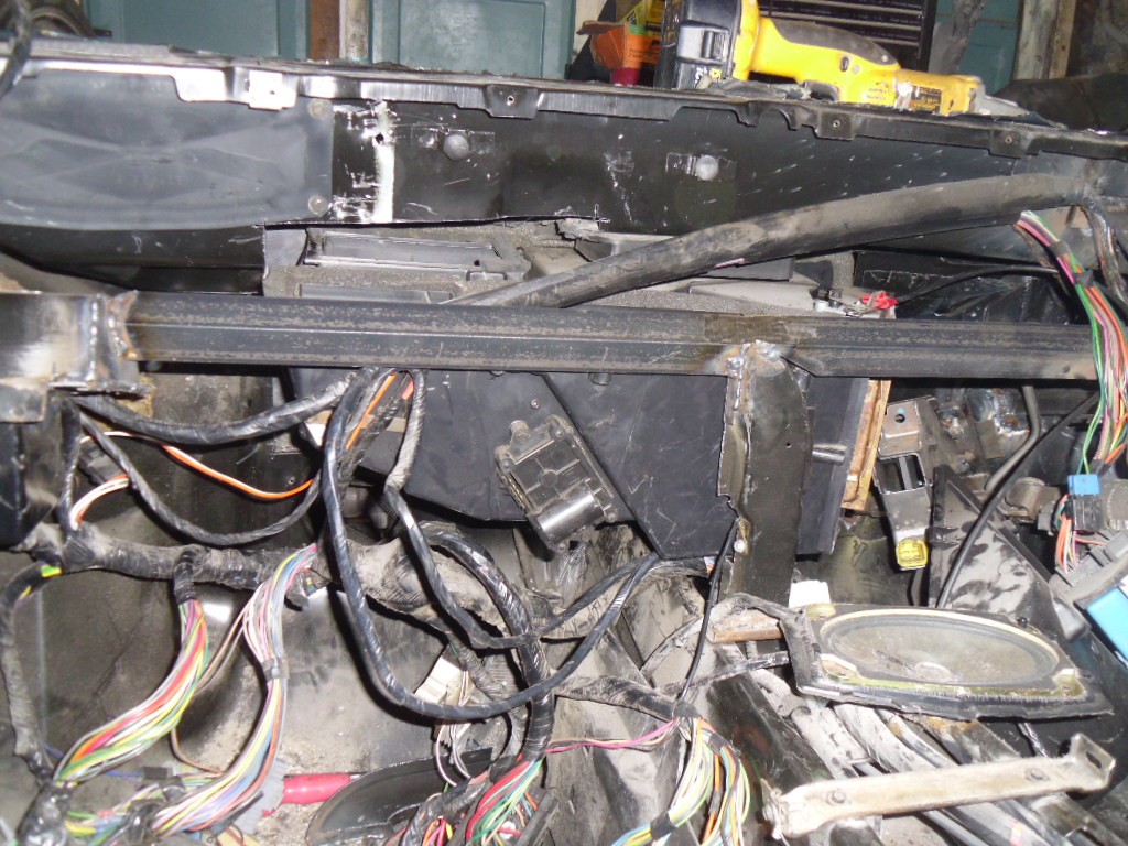

Here you can see the steeel framework to hold the steering colum in place
