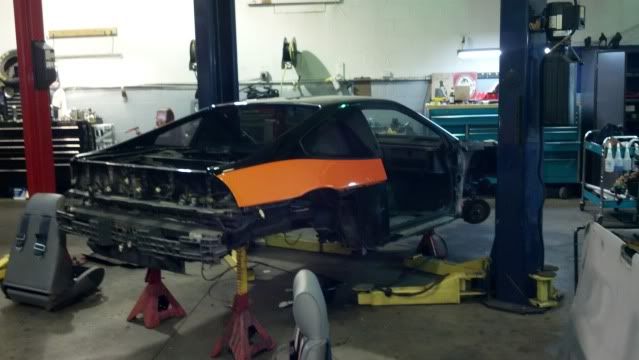

The car is my orange and black 1987 GT. It had a V8 with four carburetors that I had to hack up the frame to fit and I was originally planning on back-halving the car, but instead I purchased a 1988 Formula that had a clean rust free frame to move the body over to.

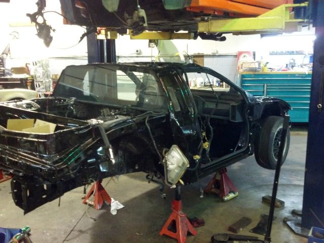

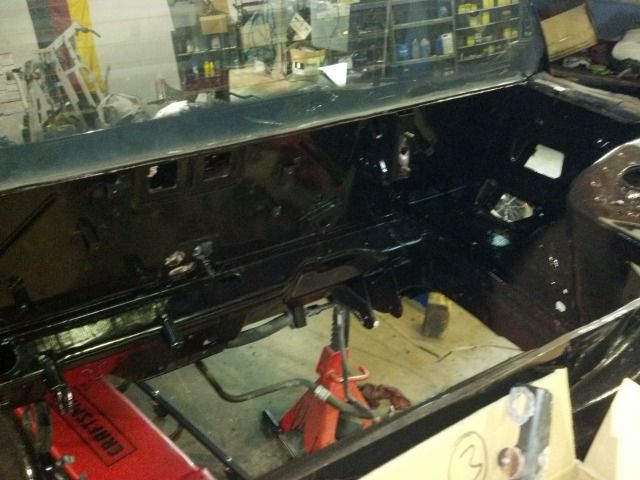

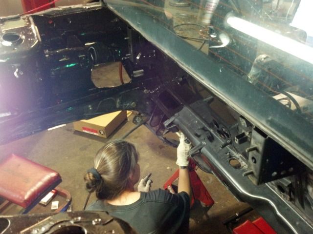

The first step was sell off the drivetrain and strip and sell off the parts not needed from both cars. Then Joey prepped and used POR15 to cover every inch of the 1988 chassis. I removed every nut and bolt and every part was individually coated. Both the interior and exterior metal was done.
The interior was insulated with Dynamat....roof, floor and behind the dash and rear firewall. The trunk was done with high temp thick insulation after we cut and resealed it.
Every small part was coated with POR15. Then new brake lines, brakes, bearings, bushings....basically everything that was a wearable part was replaced.

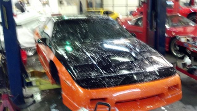

Then the body was washed and I took a claybar to it prior to removal.
Then I moved the body over one weekend. That was scary due to the $12,000 paint job...I was terrified to chip it. Joey and our oldest daughter helped.

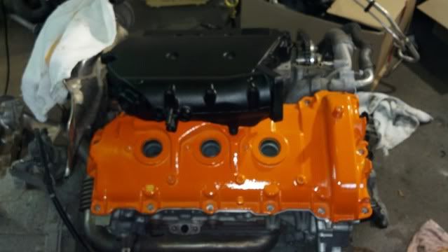

I powdercoated the valve covers with chrome base, then coats of the orange, then coats of clear. They match the exterior paint perfectly. The intake was powdercoated with wrinkle black.
In the meantime, we are porting the intake runners and the turbo is getting modified to fit a 19t compressor wheel (original size is 15t). I decided to use the stock turbocharger due to it being a twin scroll design and with larger injectors, my power goals will be met.
