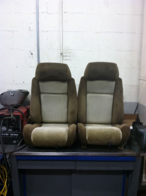

Anyway, the car is Indy #64 and parade car #4. It has 152,000 miles on it and needs a restoration. It will be a long project but I plan to get it completed and keep the car for a weekend driver. When I got the car it was not running. I found it had no fuel pressure but I could hear the fuel pump running. I removed the fuel tank and found the rubber line between the fuel pump and sending unit cracked. I replaced the pump and hose and the car runs now. The gas is a little old but I'll get it ran through and fill the tank with some new gas. I've also replaced the alternator and belt. Hopefully this week while the weather is nice I'll get the factory seat fabric reinstalled on the seats. The driver seat had a tear in the leather so different seats were put into the car by a previous owner. The factory seat fabric came with the car. I found a second set of seats and purchased them so now I have enough parts to put 2 good seats together. I also got some nicer door panels with map pockets to put in the car. The car also has a hooker header on it and a poly bushings in the suspension.

L67 OCT 12, 01:11 AM
Fix your seat color.
FieroMaster88 OCT 13, 08:55 AM
That would be today's project. I'll post pictures as I swap the covers over. I have a bunch of bmw's to fix first.
