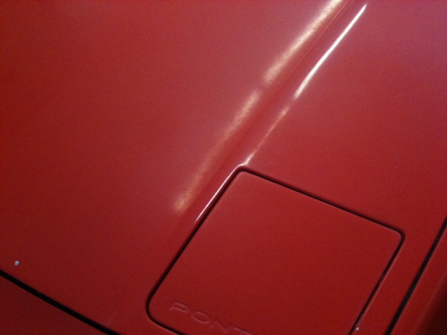

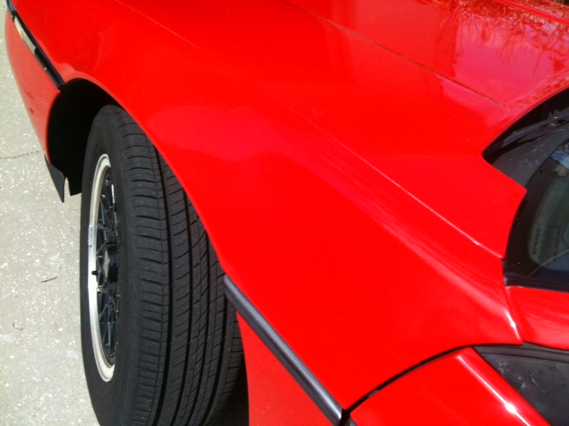

APR 15, 02:41 AM
Before buffing out the paint, every 6 to 7 months the sun fades it pretty bad.
After
Paint came out with a nice shine again. I repainted the hood vents with a black satin finish.[This message has been edited by CoolBlue87GT (edited 04-15-2017).]

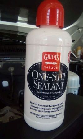

CoolBlue87GT
NOV 06, 03:34 PM
| quote | Originally posted by DeLorean00:
I know I am bumping your thread out of nowhere but I was reading the whole build thread and this thread again because this is one of my favorite builds. I see you are polishing your paint often, have you ever tried using a sealant? I have had a few single stage paint jobs like this that fade out often and require buffing every few washes. I use a little sealant and it makes the shine last much longer. You only need to apply very small amount using a microfiber towel, wipe on, allow to haze lightly and wipe back off. Its best to go panel by panel |
Okay, the paint needed polishing again, I decided to give this sealant a try.
Made the paint look pretty good. We will see if this last longer.
 [This message has been edited by CoolBlue87GT (edited 11-06-2017).]
